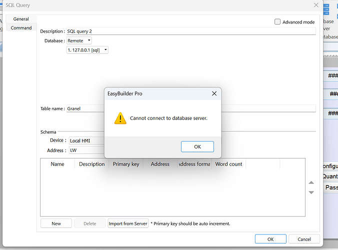

Hi,

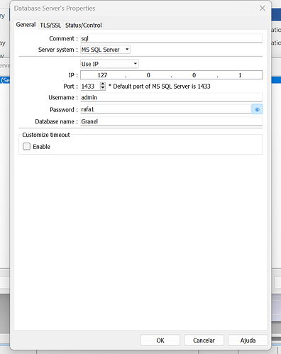

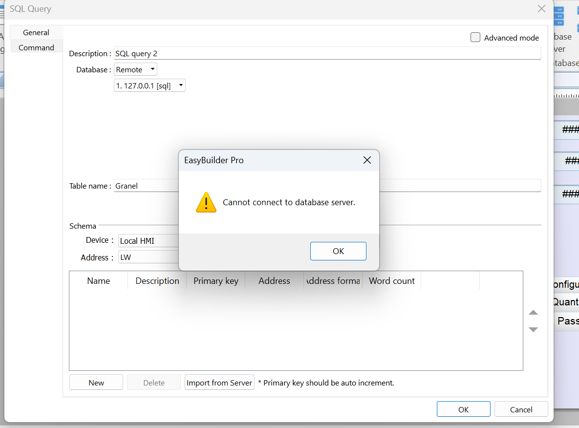

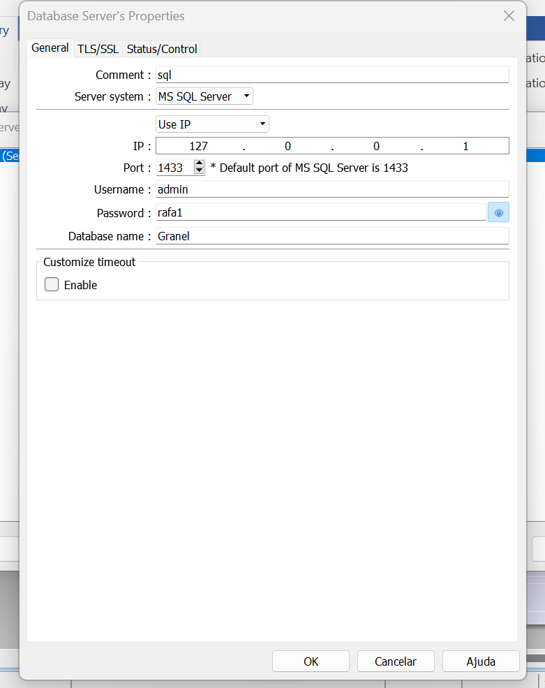

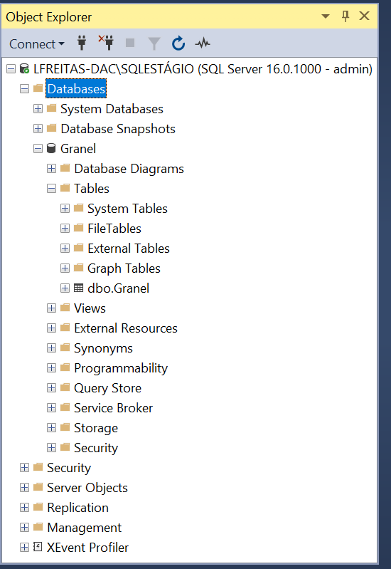

Sorry to open this again but now I can’t connect my SSMS DB to EasyBuilder and I think I’m missing something
This is the setup that I made based in one of your videos (was working before but with a different BD and table name, now it says that I can’t connect.

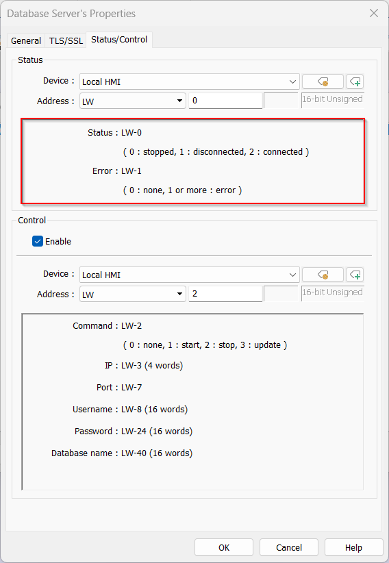

Hi @Rafaelk21,
Please revisit the portion of this video that pertains to creating a new server/database (starts at 3:38) and confirm all settings configurations are correct. If you were able to connect to a different db on this server in the past, the issue may be caused by incorrect db settings configuration. Also, please refer to the video portion that covers the database object’s status/control addresses (starts at 6:34 & demo at the end of the video). The Status and Error registers will give you a better idea of what’s causing the db connection issue.
