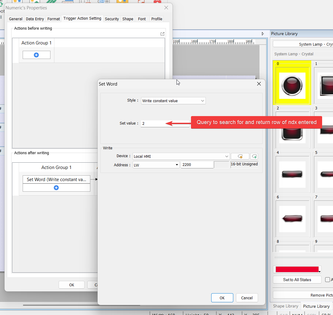

Hi @dkhayes117,
Another approach we can try is creating a custom query that searches for a specific ndx value. This process is demonstrated in the following video LINK
Using a custom search, you can trigger it through the numeric object’s Trigger Action Settings. We recommend adding a small delay before the action call to ensure stability. Once executed, the query will output the results to the memory address specified in the query command output memory registers.
Please note that the video also demonstrates how to set up dynamic arguments, which you’ll need in order to run the custom query search.
Let me know how this works for you.
Trigger to send the search command within a numeric object
Delay and trigger within numeric object
