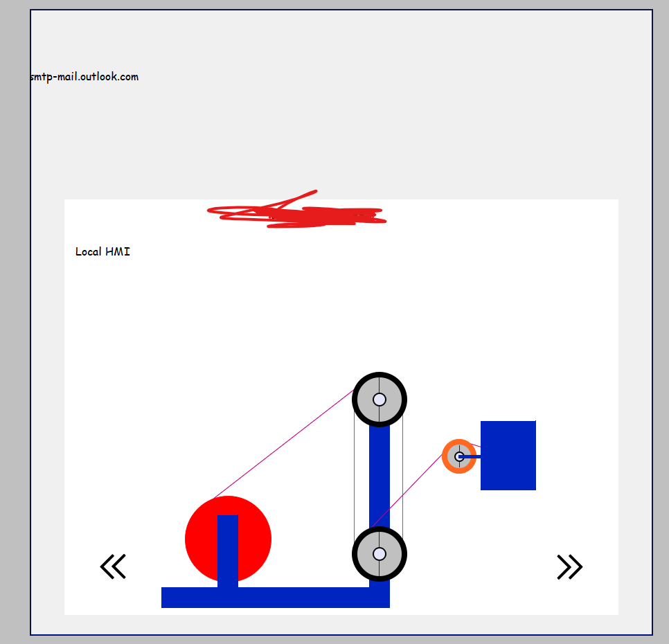

Why is text not rendering in the same way on my HMI as the IDE?
Why is text not rendering in the same way on my HMI as the IDE? https://forum.weintekusa.com/uploads/db0776/original/2X/8/8b1b653e5124a29f42d7c48828b1772c6907678f.png
  • HMI Model: cMT2166X
  • EasyBuilder Pro Version: V6.10.01.323

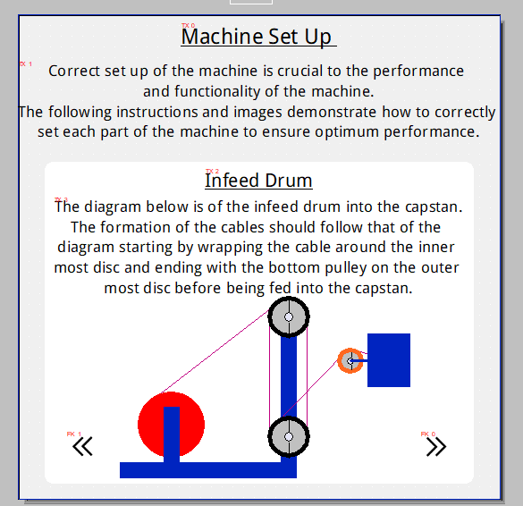

    My text is showing different in the online sim to what I have wrote as the text. In easybuilder pro it displays fine but in cMT viewer offline sim the text is showing something else somehow my password.
    The same text previously was working so I’m not sure if this is an issue with memory or something like that.
    Has anybody encountered this issue before?
    Having looked at this more i believe that is the SMTP settings being displayed, still not sure how or how to solve, any help is appreciated.

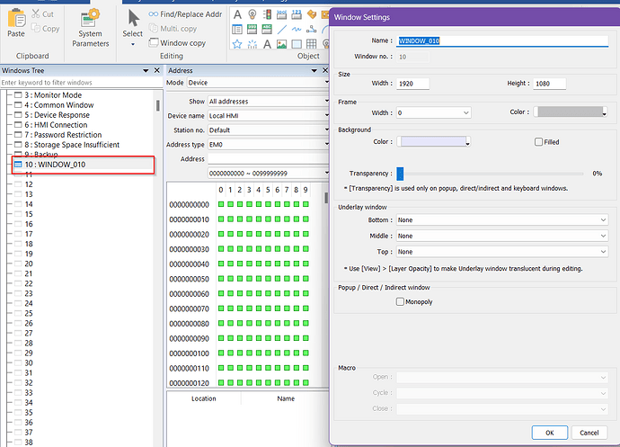

To isolate the issue further, could you temporarily move all the text objects off-screen and check if the unintended text still appears in the project? This will help us confirm whether the text objects are indeed the source of the unintended text, or if there might be an underlying window displaying it.

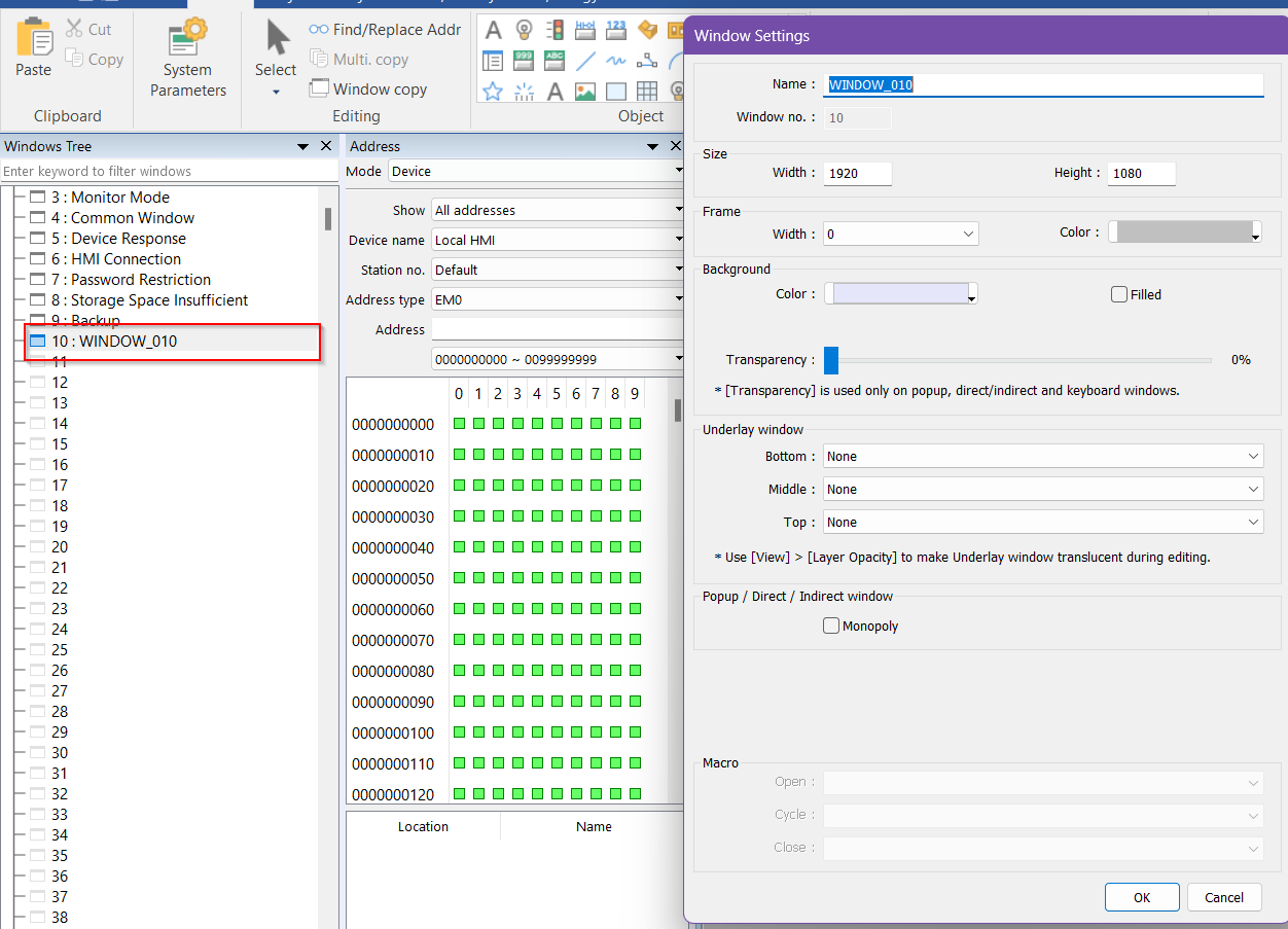

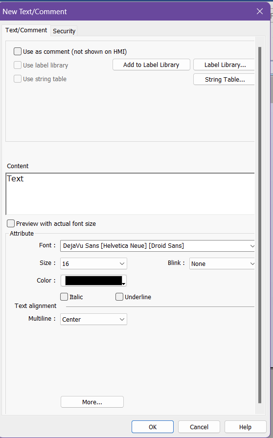

Could you also provide us with screenshots of the text object setup, as well as the window settings?
If you’re unable to see the window tree, make sure the “Window Tree” option is enabled under the View tab.
