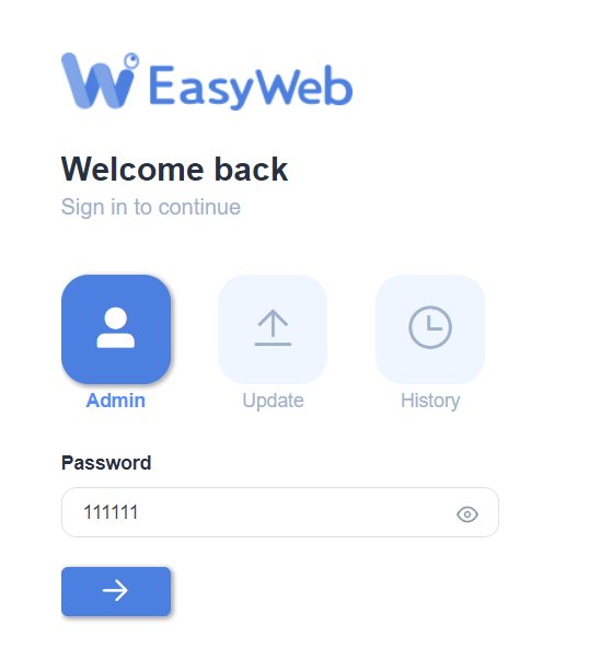

- Open Chrome, Firefox, or Microsoft Edge and enter the HMI’s IP address into the URL entry box:
- If prompted that this site is not secure, please click “Advanced” and “proceed”:
- Enter the system password to login to EasyWeb 2.0. the default password is “111111”:
Note: As described within this tutorial, the web server may look different depending on its release date.
