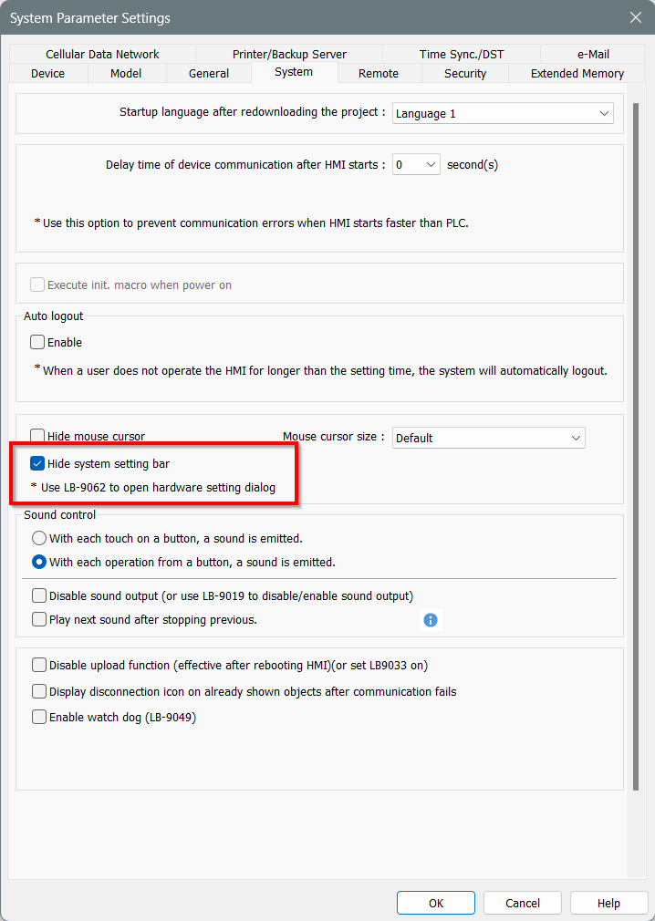

Is is possible to move the system toolbar icon from the bottom-right to somewhere else on screen? If so, how?
Hi @BrianF_NZ ,
It isn’t possible to move the system toolbar, but the alternative we recommend is hiding the system setting bar and using the LB-9062 bit to trigger the menu if needed. To hide the system setting bar, navigate to System Parameters Settings > Settings > Hide system setting bar.

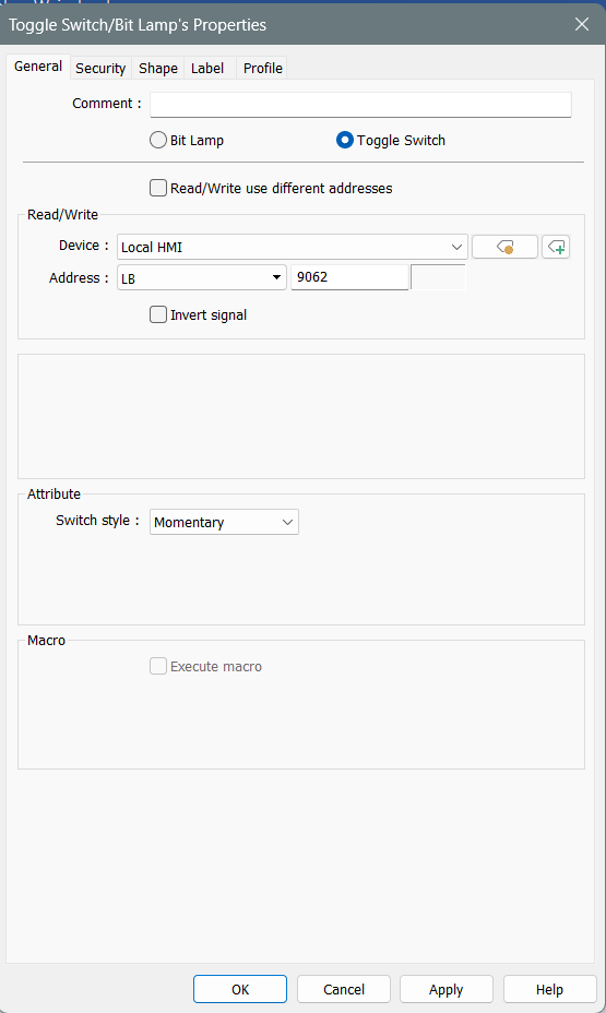

Next, add a bit addressed to LB-9062 and position it anywhere on the screen. We also recommend setting the Switch style to Momentary.
