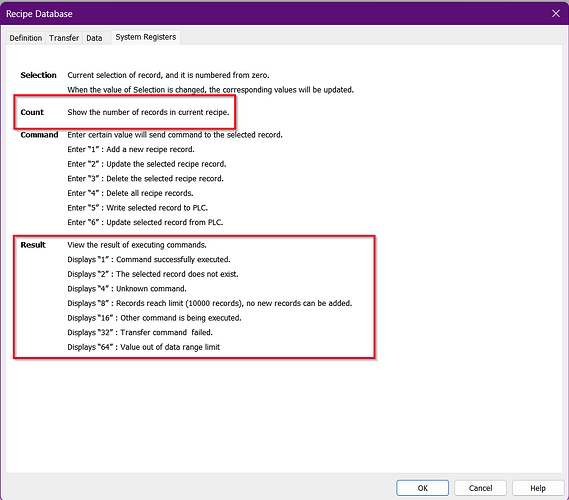

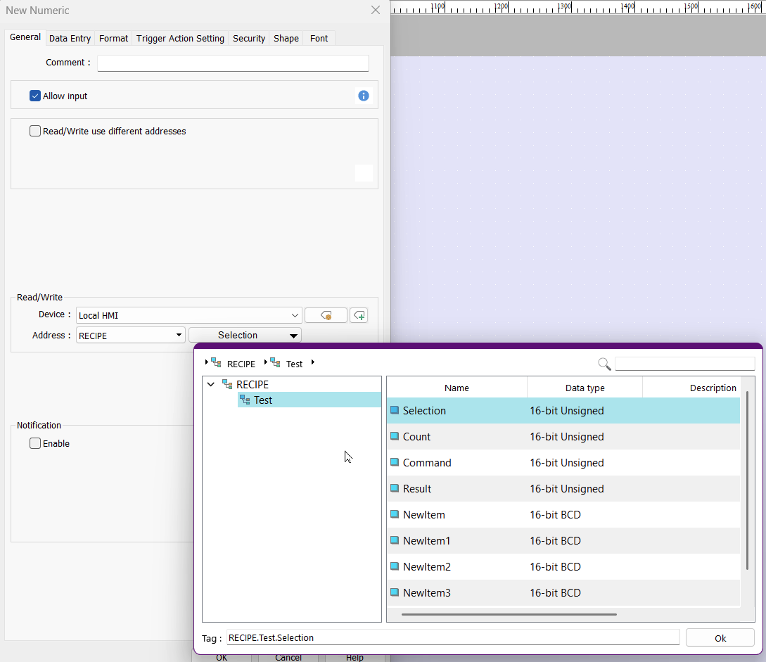

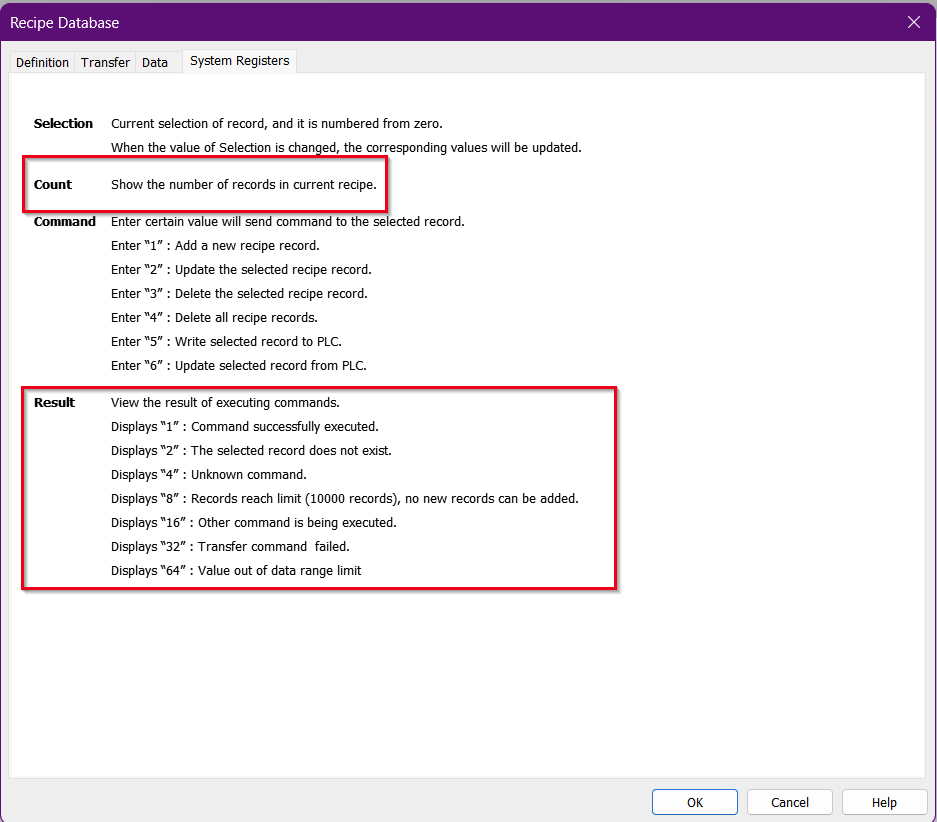

We don’t have a way to detect changes within the Recipe View object, since it’s primarily used to display recipe data. However, in the Recipe Database, each recipe has system registers you can access.
We recommend using the Count or Result register to detect changes. You can set up a macro to check when the Count value increases, or when the Result register detects a value of 1.
To access these registers, please make sure the address type is set to RECIPE. Note that a Recipe Database is required for this option to appear in the drop-down list.

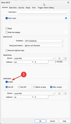

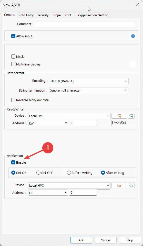

Within the UI objects you can enable this notification bit:
So for example, when the user clicks the “Update” command button for the recipe, the notification bit can track that the user submitted an update easily.
