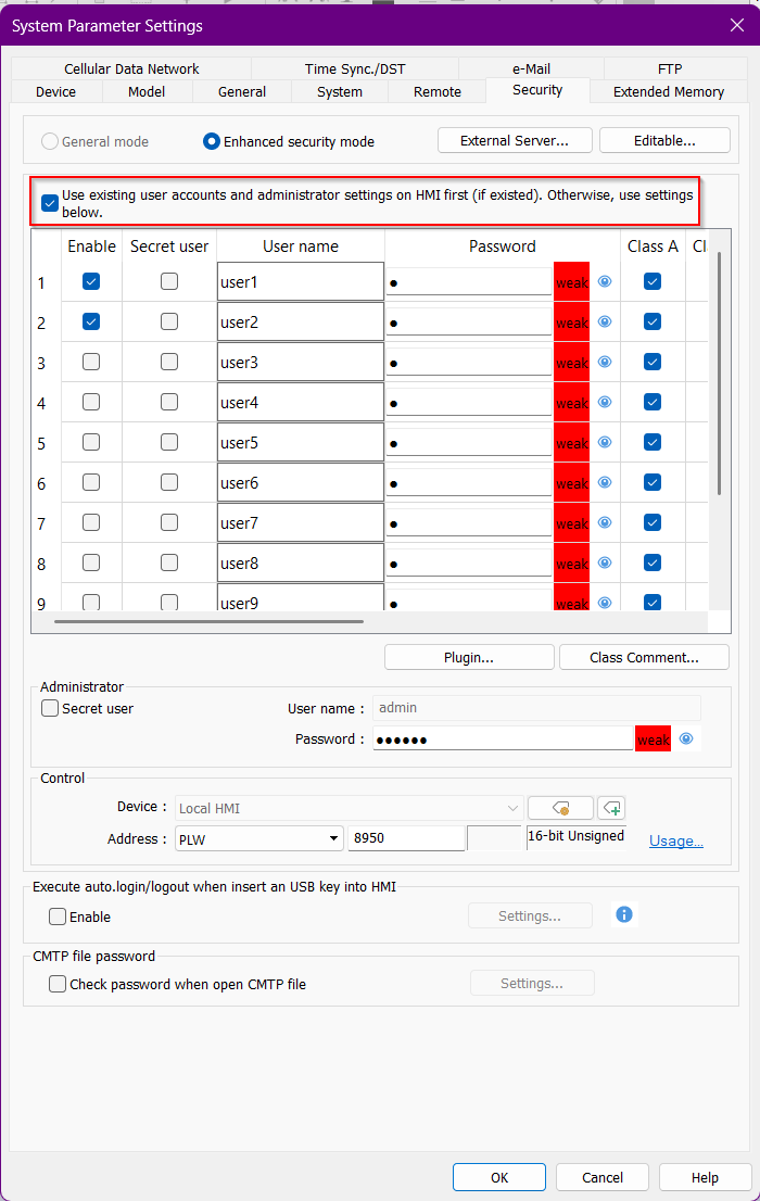

I remotely access and make changes per customer requests, but each time I download they need to add users they have created outside of what I have saved in the program. I have tried uploading the program and backing up from the web interface but have not been able to find a solution.

Could you check if the “Use existing user account setting on HMI first” option is selected within your security tab of your project and see if this resolves the issue.
