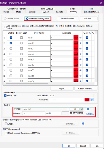

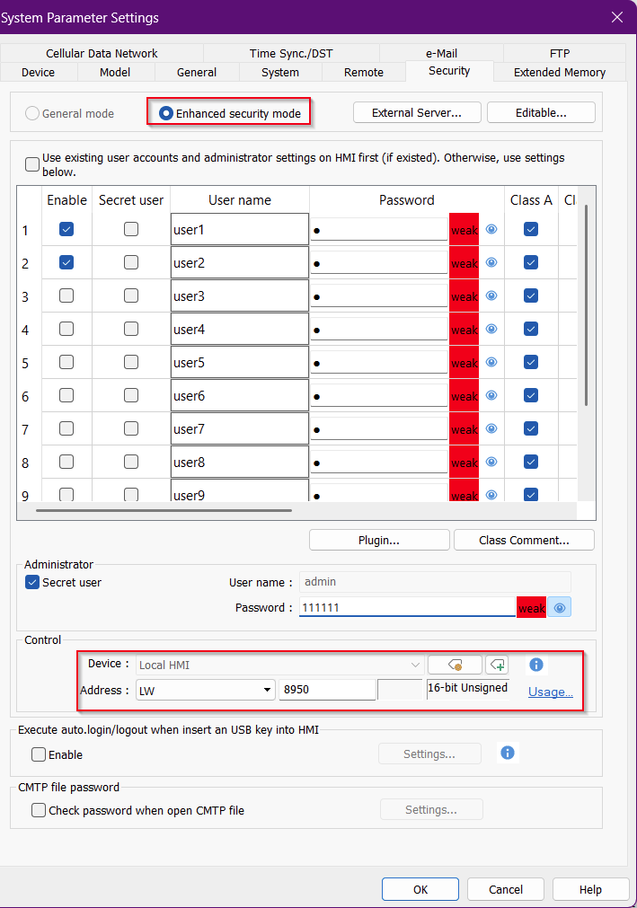

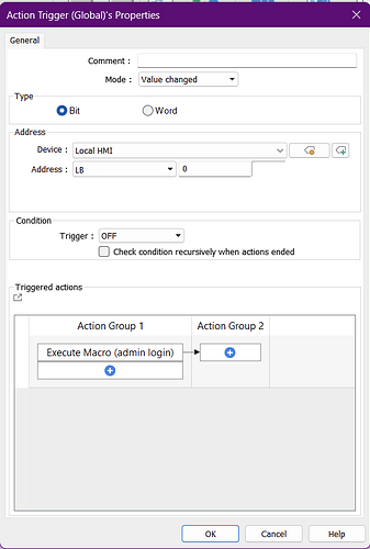

A way you can change security level is by loggin in as the admin. You can trigger a login by using a global action trigger to monitor a memory address, when triggered it executes a macro to place values to login as the admin and give you high security level access.
*Ensure that within System Parameters → Security that Enhanced security mode is selected. Also set the control address to LW registers. *
Action trigger will be addressed to PLC rather then LB 0 for the trigger.

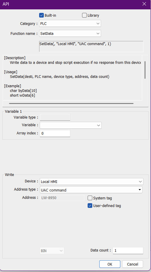

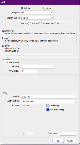

SetData(command_to_login, "Local HMI", "UAC command", 1)
end macro_command
If setting up by API select User-defined tag to find UAC
