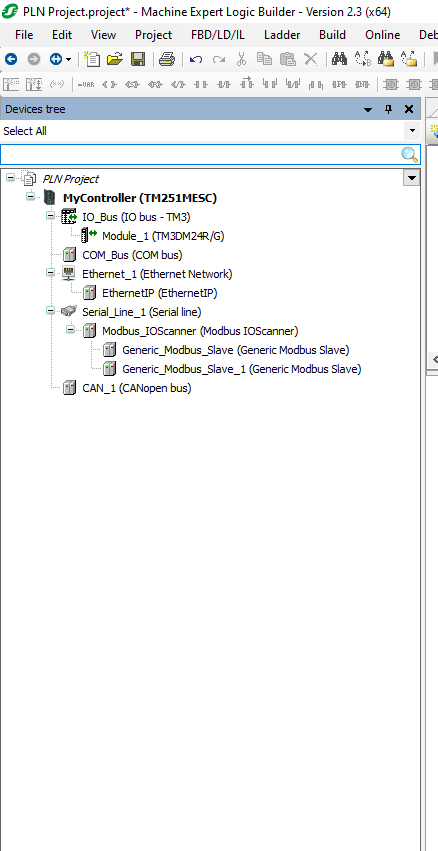

i have an issue, that i cant connect my plc (schneider M251) using machine expert to my HMI, everytime i try, the device always no respon

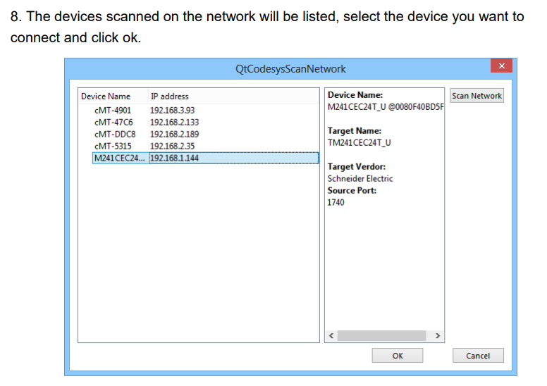

Below is a link to our PLC connection guide for the M251. Could you ensure your steps follow the instructions in this guide?
If you are still receiving the error code, could you send the serial number of your device as well as screenshots of your project to help us further diagnose the problem?
M251 Connection Guideo

im using TM251MESC, i do follow the step, but its always device no respond
Hi @izzyskate01,
Can you verify that:
  • User account management is disabled
  • POU is set within MAST
  • During Online Simulation. does the same error still show?
Could you also send us a screen shot of the scan below and your system parameters setup within EB pro.
