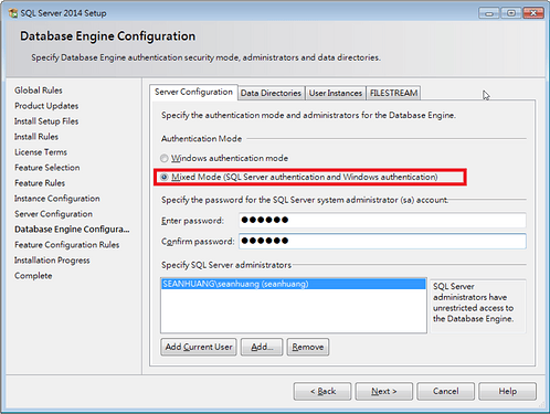

Can you please check that the database name, username, and password are correct? Also, during installation did you enable “Mix mode” for the server authentication as shown in our instructions?
