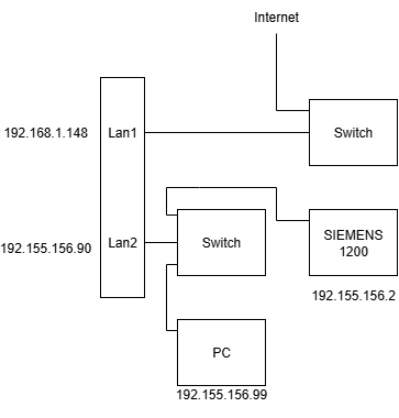

I’m using cMT-FHDX-820 hmi, at Lan2 plc is connected, Lan1 is connected to internet.
At Lan2 there is also PC that has cMT viewer, PC don’t have internet connection.
HMI sends data periodically to internet, but when PC is connected with cMT viewer and data sending is initiated from PC(for example sending login data to backend), HMI is acting like there is no internet connection, periodic data sends initiated by hmi are still working. If I connect PC to internet then everything is working OK.
Is there solution where PC is not connected to Internet but it can initiate web commands?

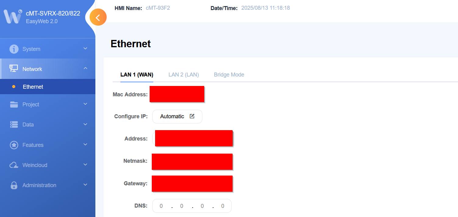

Could you confirm that the SVRX is receiving a Wi-Fi signal through LAN1? This can be done by going to the IP address of the HMI in your browser.
If this seems correct, could you provide us with images of your setup to further diagnose the issue?
Hi Aaron,
Yes LAN1 have network settings.
Here is setup diagram
Hi @lgoitc,
When using cMT viewer the PC emulates the existing project as a separate instance and may process data and logic within JS on the PC itself. One solution may be to use a subscription to read a local HMI bit (LB) and trigger the API call. This might allow the JS object to run only on the HMI. When you have time, can you please implement this method and let us know if the issue is resolved?
