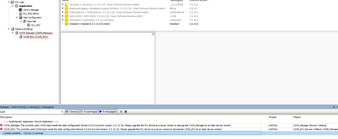

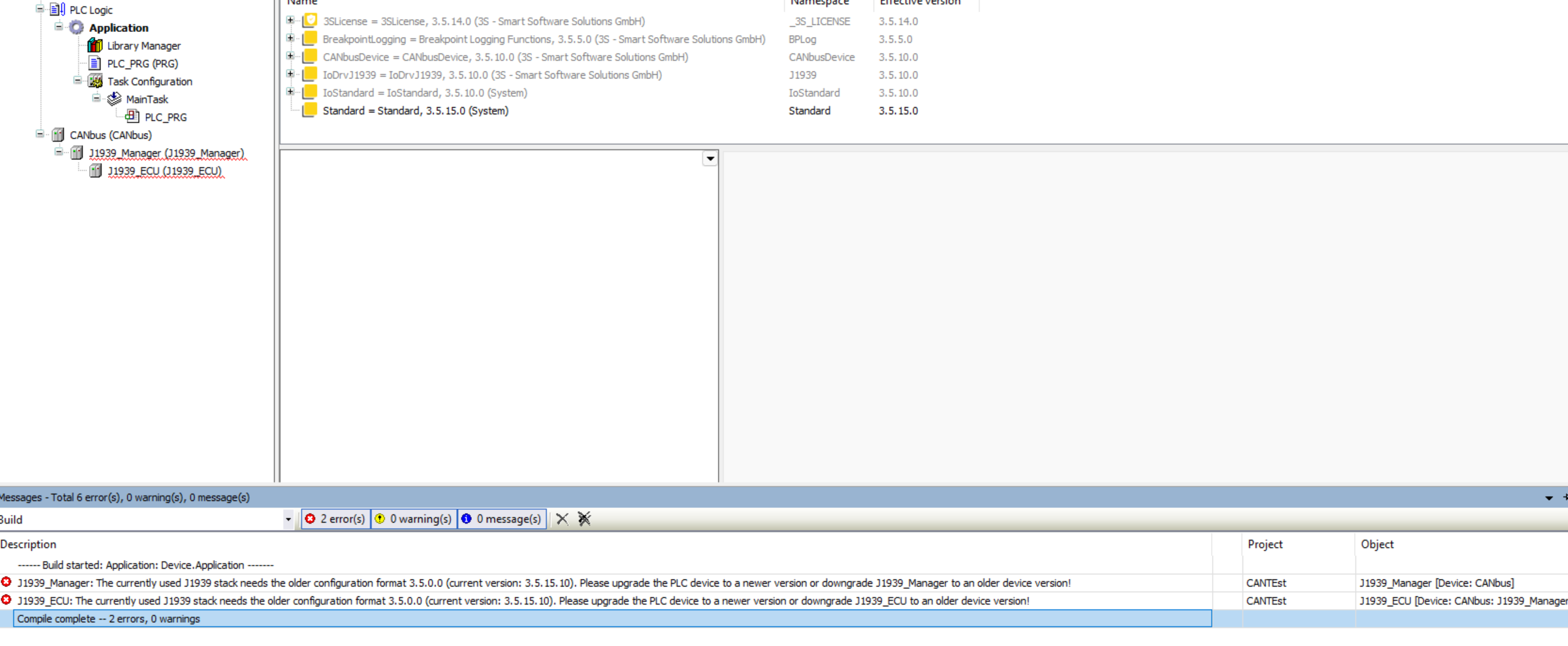

I see the FAQ specifies the CANOpen protocol for the CAN adapter, but I’m curious if J1939 is also supported? Trying to add a J1939 manager and ECU to my project I get a library error, so I’m guessing that’s a no… but thought I should ask anyway to see if there’s a work around.

At this time, J1939 isn’t supported. Our CAN adapter functions only as a CANopen manager.
