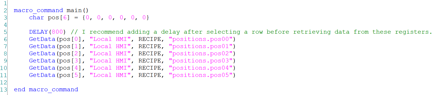

Hi @cncgeorge,
If possible, I would recommend that you use a GetData() function to retrieve the current parameters at the selected index. Here is an example:
Can you please try this alternative solution and advise if it resolves the issue?
Note: The RecipeQuery() function is more appropriate for searching a large db. When the item index is the “selected” item, you should use GetData() instead. It is not possible to search where the index is equal to the selected index, because the selected index is not a field within the database that can be queried.

@cncgeorge,
As a simple workaround, I would recommend the following solution:
  1. Enable “Bulk Transfer” to send recipe data to a local HMI address within the “Transfer” tab of the recipe database:
  2. Then, configure a macro to read from the address specified wihtin the bulk transfer. Here is an example:

@cncgeorge,
My sincere apologies, this is a typo that will be addressed in the next revision of this document. Currently, the “RecipeQueryGetData()” command only works with a static string.
