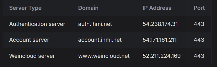

Error code 12 relates to a certificate error. Can you ensure the “Time/Date” is correct on your HMI. Within your network, can you also ensure the following IPs are whitelisted, as these addresses are needed to connect to Easy Access.
Please let me know if the issue persists.
