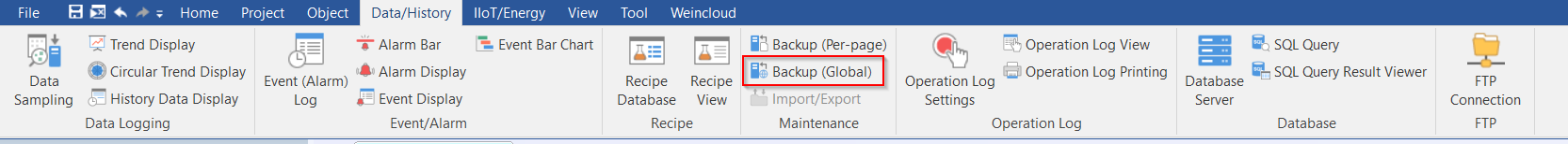

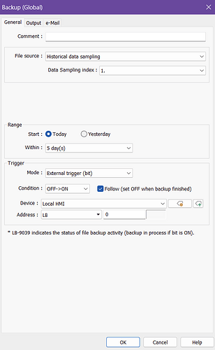

The Backup object is located within the Data/History tab. Here, create a new backup object.

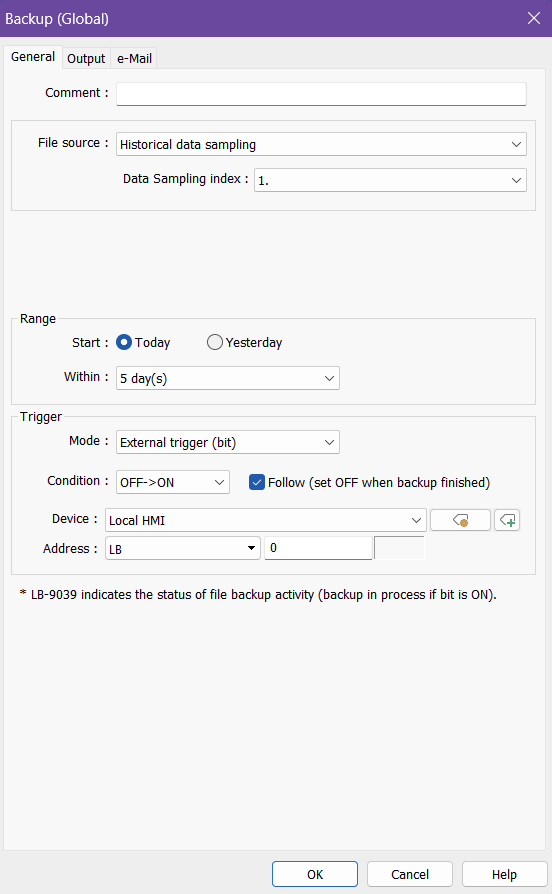

Within the General tab, I set the trigger to my LB-0 bit and my File Source as a Historical Data Sampling object. This allowed me to choose the data sampling index I wanted to email.

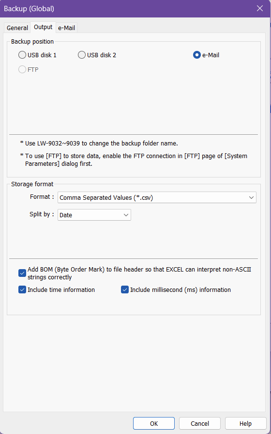

Next, in the Output tab, I set the Backup Position to email.

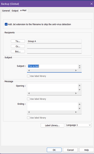

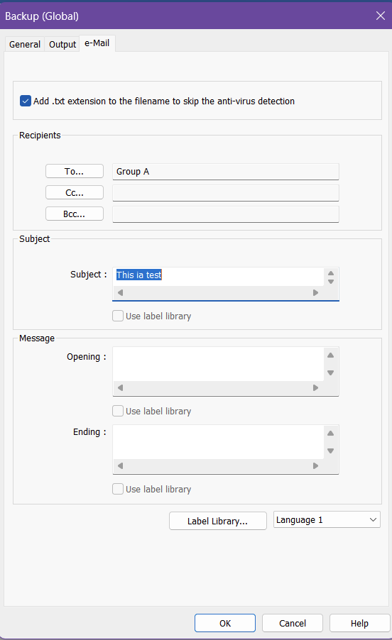

Lastly, within the Email tab, I added the group of email recipients I want to receive the email.

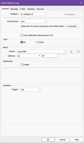

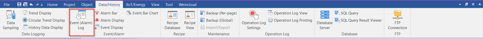

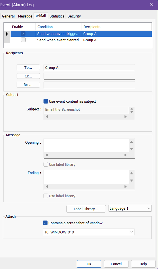

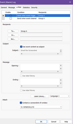

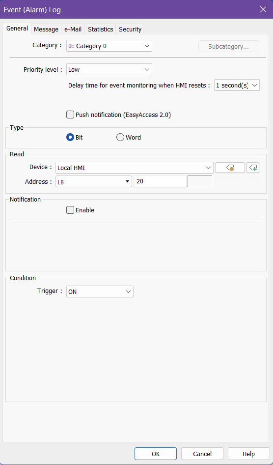

For the screenshots, I created a new Event (Alarm) Log.
In the General tab, I set the read address to LB-20, as this will be my trigger to send the screenshot.
Lastly, within the Email tab, I enabled the condition Send when event triggered. This allows me to enter the recipients and attach a screenshot of a window using the option near the bottom of the popup window.
Now I can use LB-0 for emailing logs and LB-20 for emailing screenshots. Please let me know if you run into any issues.

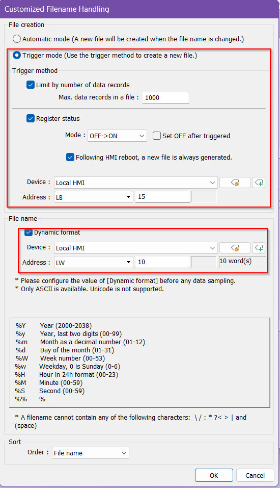

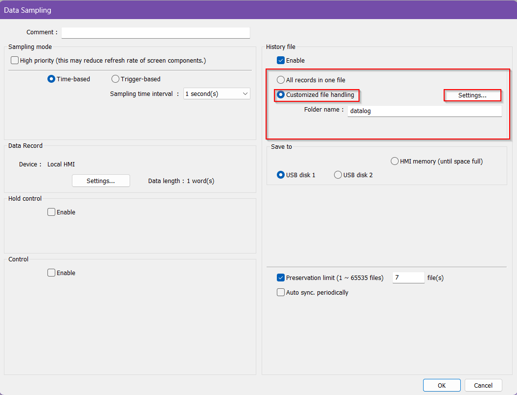

  3. To separate the data log files:
  • Navigate to the Settings of the Data Sampling object. Here, select the Customized file handling option. Then, click the Settings option.
  • In the example below, I set up my file creation to trigger when the LB-15 bit is activated and allows user input of a new file name at the LW-10 address.

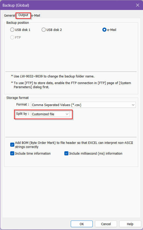

  • Lastly, within my Backup (Global) settings, under the Output tab, I modified the Split by option to Customized file. This allows the emails to be separated by file name. Therefore, when a new batch needs to be started, I can trigger the LB-15 bit, enter a new file name, and then save the batch only.
