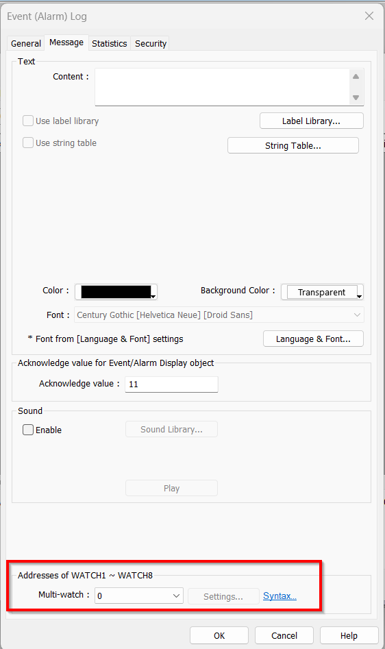

  • Is there a way to read data from a string tag in the plc and have populate a alarm message?
Hi @rday1971,
Here is a link to our alarms and event logs video. In the video the multi watch feature is set up to read in data from a memory address. I would recommend a similar method be used to display the string tag in the message.
Please let me know if you have any questions!
