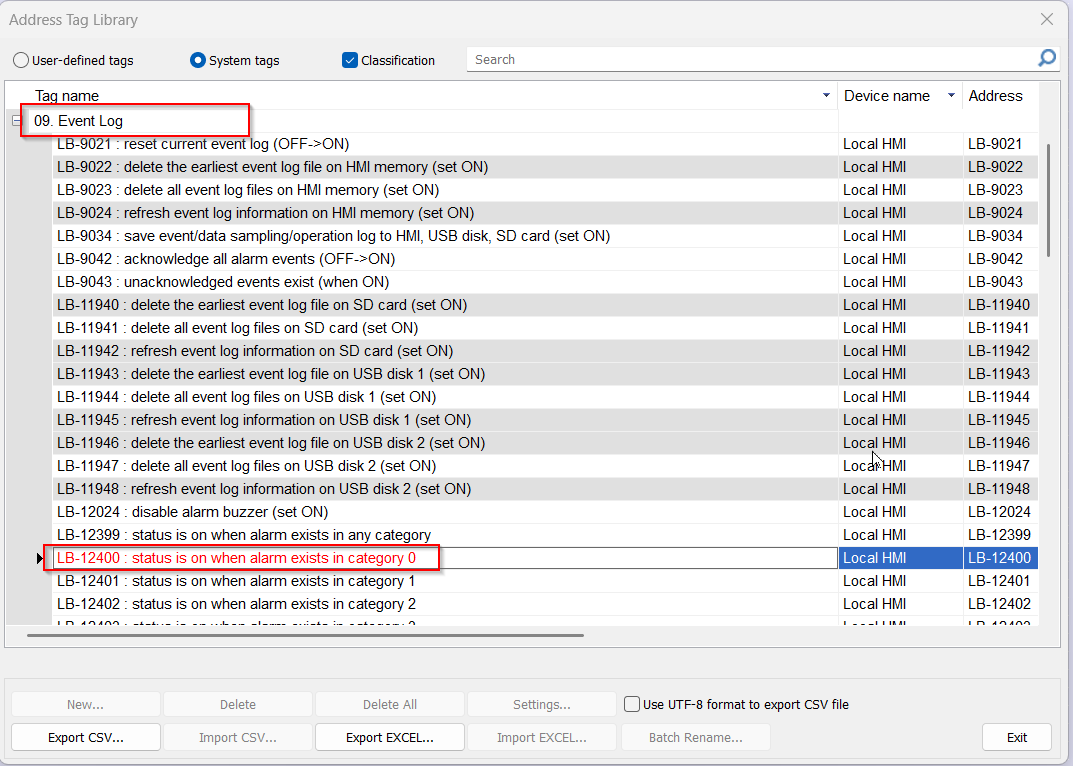

Unfortunately, it is not possible to acknowledge specific alarms based on their category. Some system tags you may be able to use are LW-11500, which shows the number of alarms in Category 0, and LB-12400, which indicates when an alarm exists in Category 0. These can be used to notify the user to acknowledge alarms by pressing on them individually rather than acknowledging all alarms at once.
Please let me know if you have any questions.
