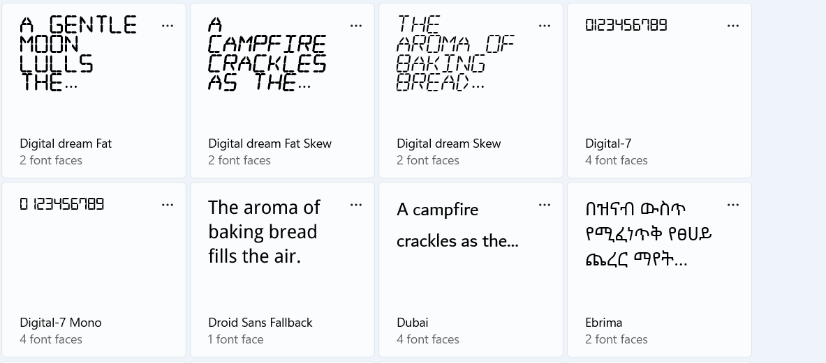

- Installed Font as per instructed EasyB uilder 8000 will not show the font.
- EasyBuilderPro shows the fonts no problem.
- Shows up in all other programs as well I use as well.

I am getting no errors and the HMI is using the font. I needed to a backup and restore onto a new but same model HMI. When I did this it did not show the font correctly. So I decompiled the program and system told me I did not have DF7 fonts installed. So I installed the fonts for All Users and they will not show in EasyBuilder 8000 text drop down menu. I have uninstalled and reinstalled the program. Deleted and reinstalled the fonts as per directed. I tried other fonts as well and they will not show.
