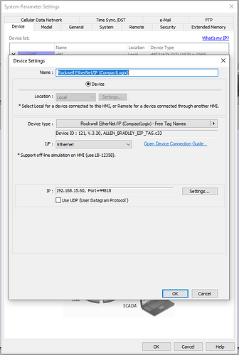

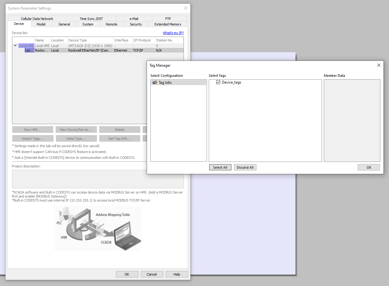

Get Tag Info does not display PLC tags https://forum.weintekusa.com/uploads/db0776/optimized/2X/7/76d22e02d95d2a39be3de1d91c874e55d2e5d5a6_2_1024x753.png
  • HMI Model: cMT 3162X (v2)
When I click the “Get Tag Info” button it does not seem to display any of the tags in the PLC or from the offline program file.

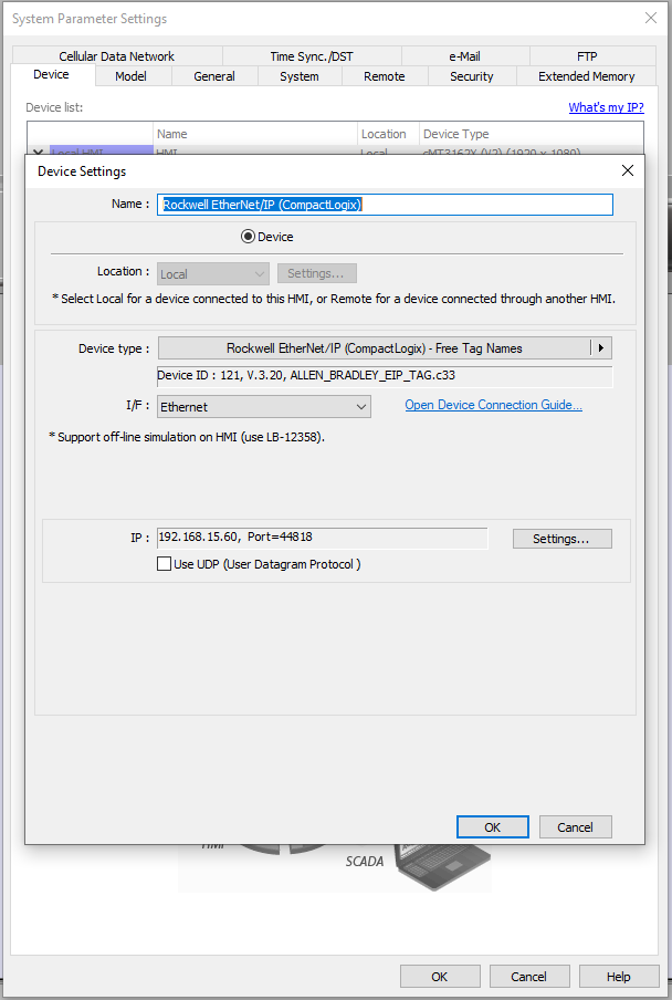

Which driver are you currently using to get the tags?
Hello Aaron,
Thanks for the quick reply!
I am using the Rockwell Ethernet/IP (CompactLogic) - Free Tag Names.
I have verified I can ping this PLC.

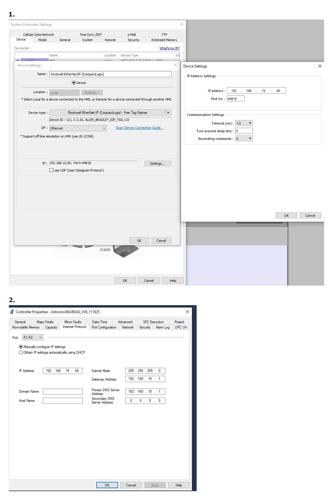

Hi @rday1971 ,
Thank you for confirming that for me.
LINK
Above is a link the PLC driver guide. Could you ensure the PLC IP address is set up correctly within PLC software as shown within the guide. If get tag info still doesn’t work could you try the importing tags via a L5X or CSV file.
Please let me know of the outcome. Thank you!

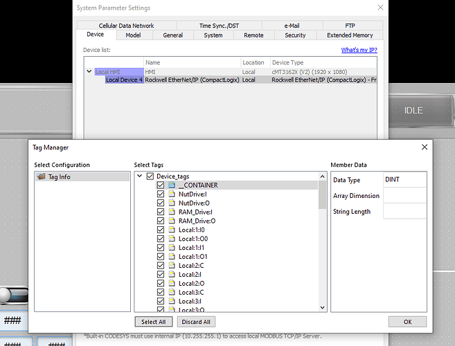

Hello Aaron,
I can confirm rolling my PLC firmware bcak to version 37 allows me to import the tags.
Hi @rday1971 ,
Glad to hear that work. We will note this for our developers and let them know. Thank you for updating us on your finding !!
