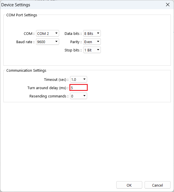

i’ve been searching this everywhere but found nothing, is it possible to set the polling rate for numeric/word objects in modbus devices? I monitored the comms and the HMI sends tons of requests to the device. I feel that it’s too much for our use case, would be nice if I can set it 1-2s period

Hi there,
If you want to adjust the polling rate you can add a small COMs delay to help reduce the load. To do this, just add a delay within the "Turn around delay " settings in the driver configuration.
It is important to note that this will affect all objects within that selected driver. Also, please keep in mind that a delay too large may result in a communication error.
