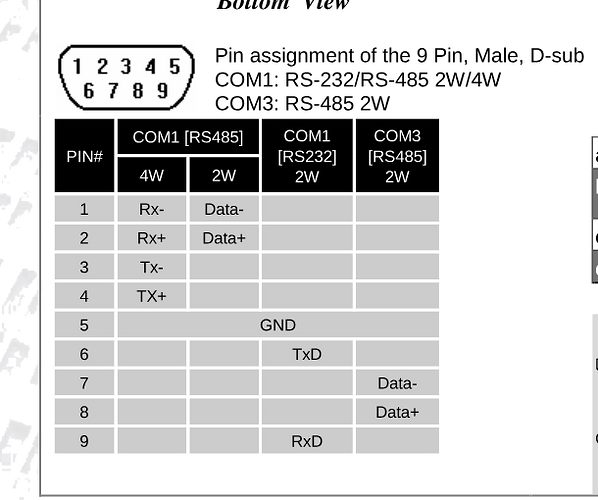

I need to know how I can communicate a MT8051iE HMI with a Veikong VFD500 using 2-wire Modbus
Hi @jgarcia12 ,
If the Veikong VFD supports a 2 wire Modbus RTU connection then you can use the Modbus RTU over TCP driver. Below is the link to the PLC driver guide for Modbus RTU over TCP.
Please let us know if you have any questions.
Modbus RTU over TCP connection guide
MT8051iE Data Sheet with pinout
