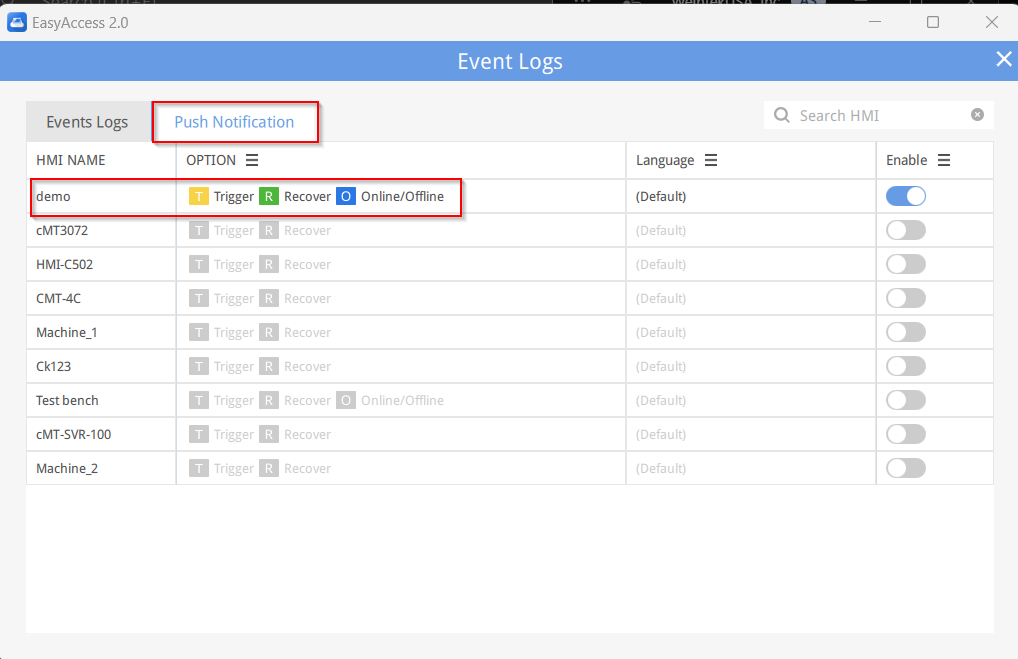

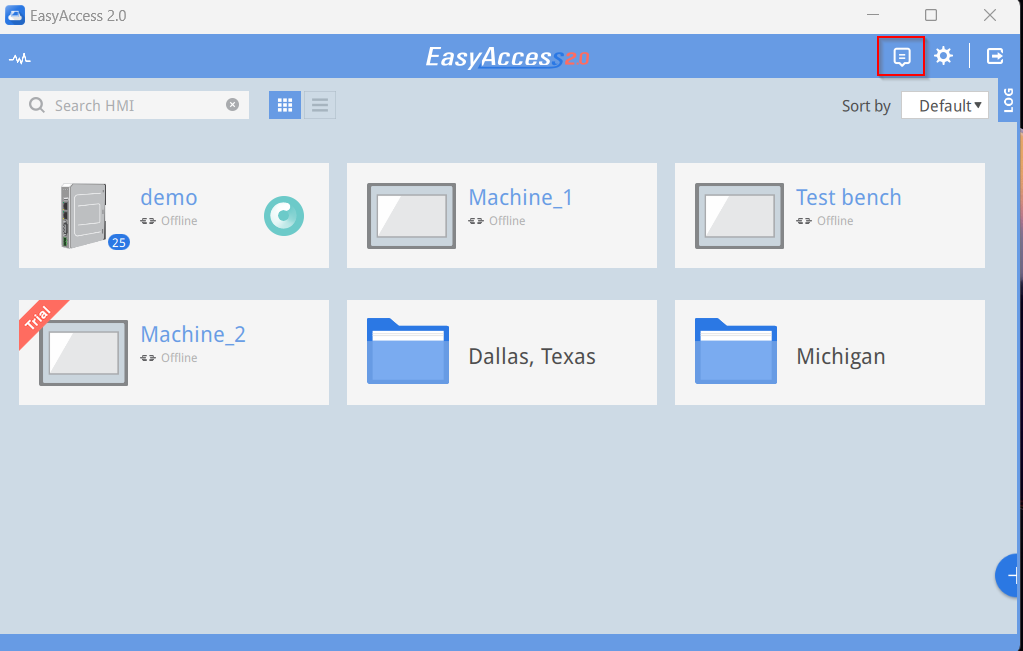

One possible solution, if you have the EasyAccess application running in the background, is to send push notifications when the device goes offline. To do this, open Event Logs:

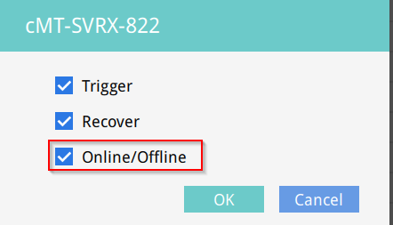

Then within the Push Notification, clicking on your HMI and adding the Online/Offline option.
Note: It can take a few minutes for the push notification to be sent; in testing it was not as immediate as the Trigger and Recover notifications.

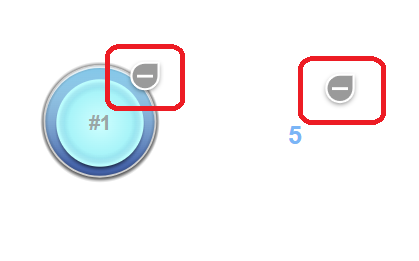

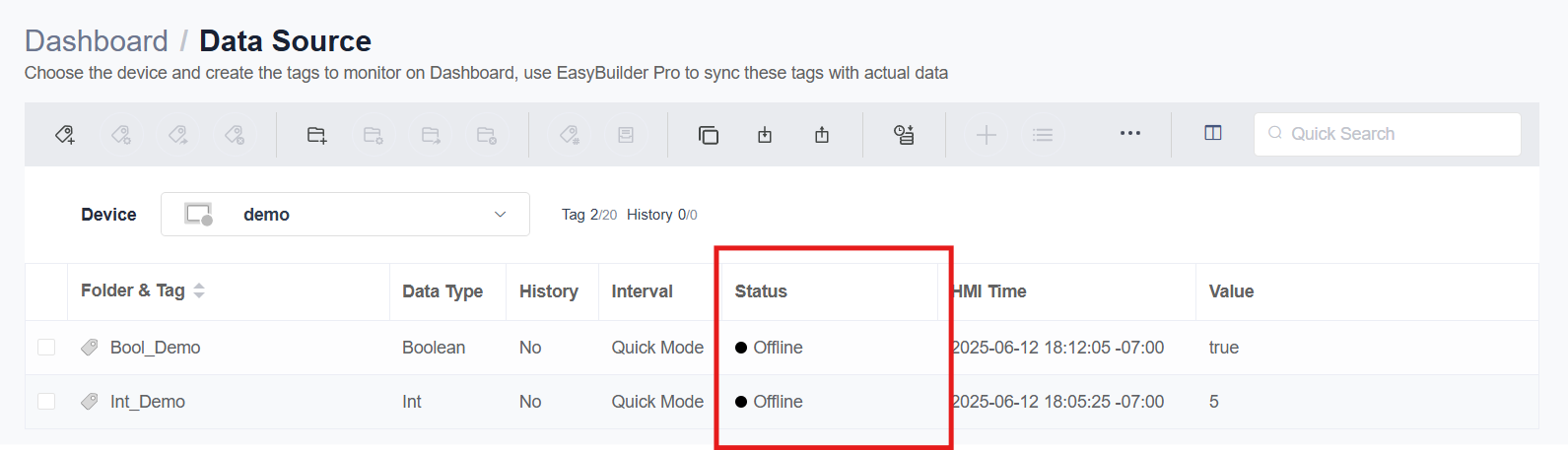

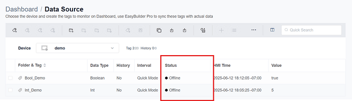

Hi @Raptor
Dashboard cannot issue a report when a device is offline at the moment. If you do want to use Dashboard my best suggestion would be to keep an eye on the status of tags under the Data Source tab, or look for the offline symbol when viewing your dashboard.
