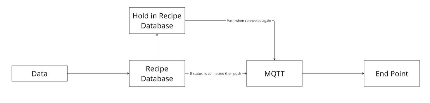

One approach is to use the recipe database as a temporary buffer before forwarding messages via MQTT. By leveraging macros to introduce delays, monitor connection status, and manage the buffered data, you can throttle your message flow and prevent broker overload that might otherwise cause connection losses.
Flow Overview
This is the Youtube video referenced start testing this project: How to use the “Normal” MQTT cloud service to connect to an AWS IoT server - EasyBuilder Pro
To run the demo:
  1. Open the file in EasyBuilder Pro.
  2. Enter your AWS IoT endpoint, private key, certificate, etc.
  3. Deploy to your cMT/HMI and start testing the buffered-publish logic.
Demo Download
Macro Used
Note: I have used placeholder values from EB pro objects for this demo. Please modify the code to fit your project.
