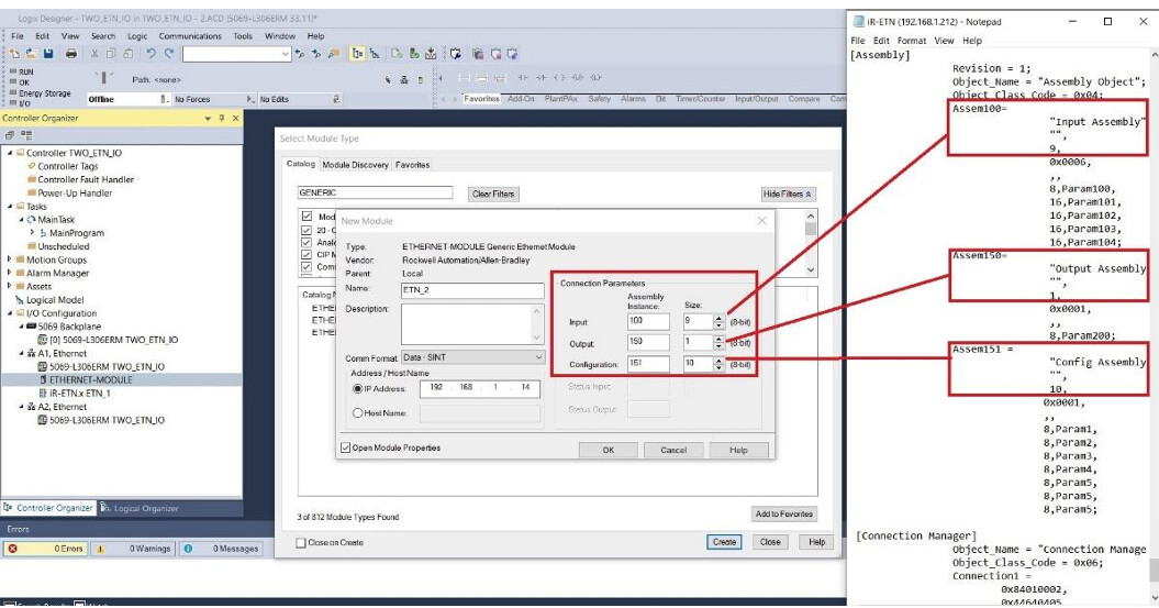

I am trying to create EDS files for Multiple different configurations on a Allen Bradley ControlLogix PLC. I had initially created 5 of IRETN 2 configs with 8 cards in them and 1 with 3 modules 1 with 7 modules and 1 with 5 modules but now I need to add more to them some need digital inputs and some need analog inputs and now my IO Configuration shows question marks on the modules that I haven’t done any changes to. I can’t add the new EDS files they do not show up in add new modules. Not sure how to fix this issue.

Within the Allen Bradley software, each device requires a unique EDS file. For set up please add a Generic Ethernet Module, fill in the connection parameters for the EDS file, and RPI should be set to the default 10ms.
Please let me know if this works, if not could you send us screen shots of your project.
