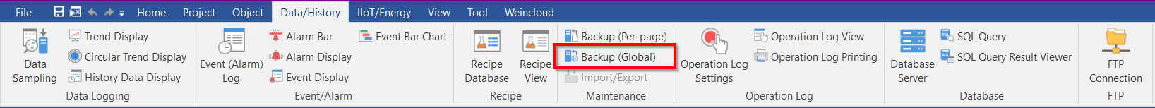

Hi @paulqiu,
I recommend using the Backup (Global) object to transfer all of your data.
Within our manual the Backup object is located within chapter 13 section 24.
Please let me know if you have any follow up questions.
