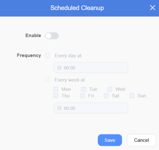

Is there any way to automate this process?
Hi @Cstarr ,
Thank you for your question. To automate this process, you can set up a Scheduled Cleanup to automatically clear the browsing data.
Please give this a try and let us know if you have any questions.
