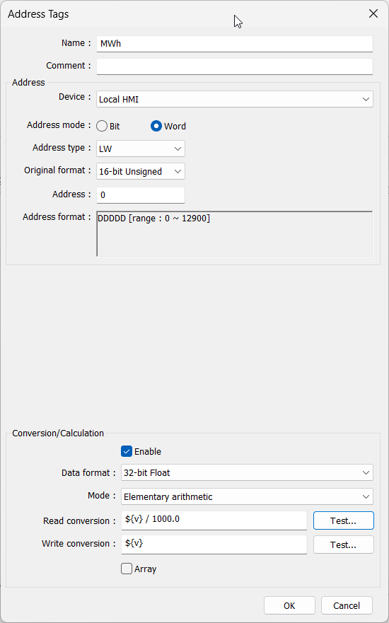

In some cases, you can also create a simple tag as shown in this video and use the “Elementary arithmetic” feature to perform the conversion: Link
Thanks a lot for the details.
I used the same and somehow wasn’t using the correct data type.
Anyway, it’s working now.
Thanks.
