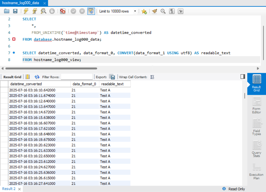

SELECT datetime_converted, data_format_0, CONVERT(data_format_1 USING utf8) AS readable_text
FROM hostname_log000_view;
Where hostname_log000_view is the table, the time@timestamp is the column that holds the Unix time data sourced from the data sampling output, and data_format_1 is the blob data.

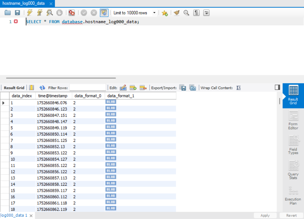

Within this view the rendered table looks like this:
However, with this view the output is as shown:

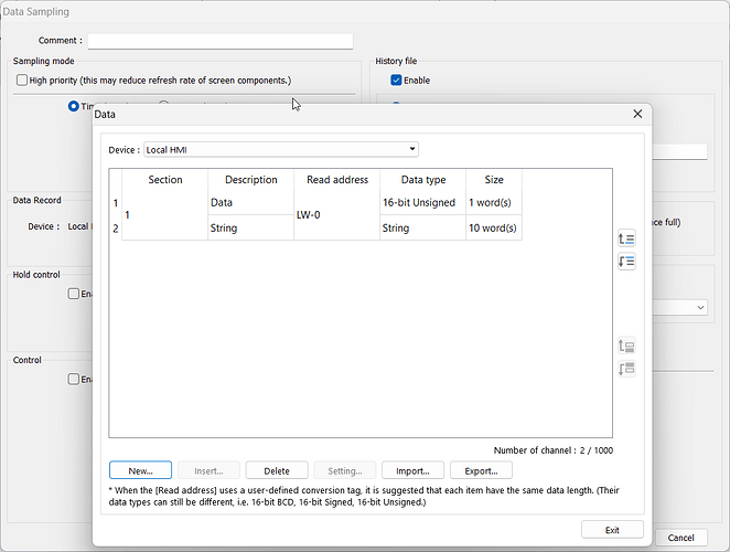

The settings of my data sampling object in this example are as follows:
