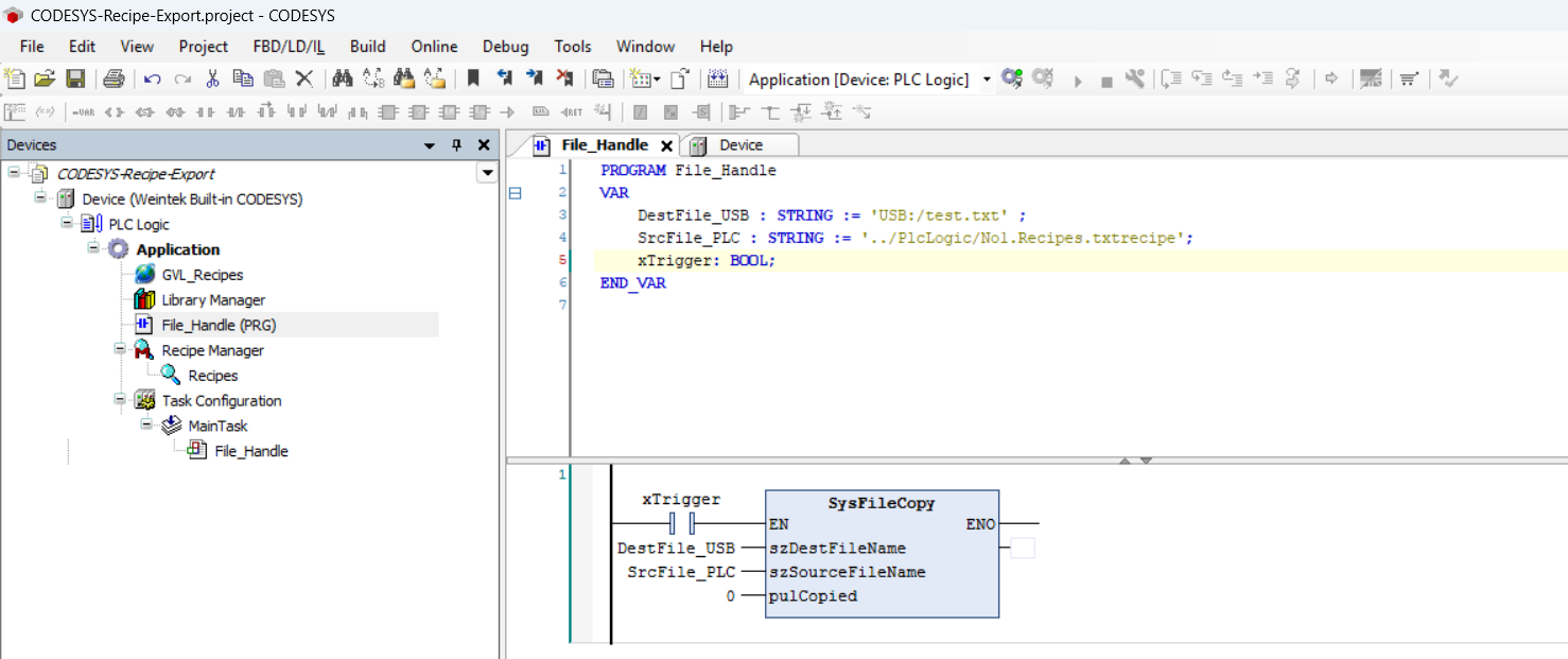

As long as the CODESYS Recipe Manager is set to save files within the internal storage, you can use the “SysFileCopy” from the SysFile library to transfer this data to a USB as shown in the image below:
Here is the a demo project that can perform this operation: Link

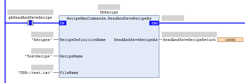

Looks like I cannot put a path pointing to USB storage into RecipeManCommands either.
Hi @vladmen,
Per my suggestion, please export the files within CODESYS’s internal storage then use the SysFileCopy function block from the SysFile library to move these files into USB memory. This will make the files accessible to the HMI’s File Browser.
However, depending on your use case, you may also be able to use other functions within the SysFile library to create blank files with the same file names as those in your CODESYS recipes.
