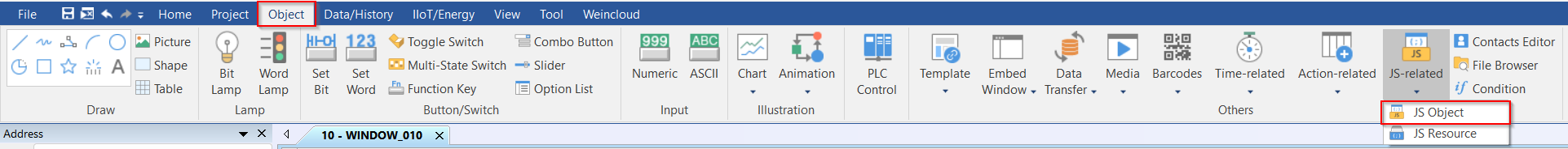

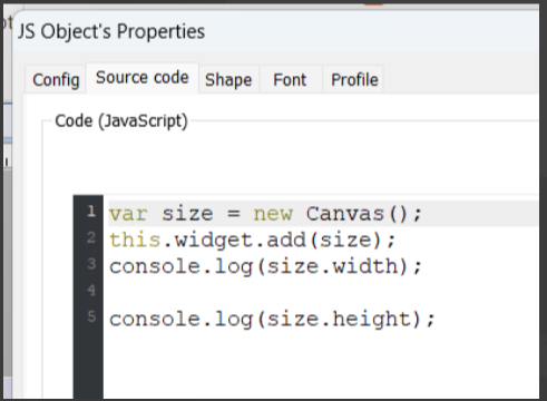

One way to get the screen size from a JS Object is to size the JS Object to match the screen (or the bounds you need), then read its width and height attributes from the Canvas widget . To do this, place the following code in the Source tab of the JS Object:
Note: You can find the JS Object in the Object palette under the JS-related dropdown list.
More information for our JS object can be found within our JS SDK:Home - JS Action/Object SDK
Thank you. I wanted something more versatile, without the extra manual work. But I guess I can’t do without it.
I have placed another JS object sized to the screen resolution in CommonWindows, where I get the size of this object and write it to the memory of the JS context.
let ScreenWidth = this.widget.width;
let ScreenHeight = this.widget.height;
window.memoryStorage.setItem(“ScreenWidth”, ScreenWidth);
window.memoryStorage.setItem(“ScreenHeight”, ScreenHeight);
So, when clicking on a JS object, I read the widget parameters in CommonWindows, check if the dialog fits and if not, I move the position.
let ScreenWidth = window.memoryStorage.getItem(‘ScreenWidth’)*1;
let ScreenHeight = window.memoryStorage.getItem(‘ScreenHeight’)*1;
Maybe it will be useful for someone. I would be grateful if someone can suggest a better solution)
