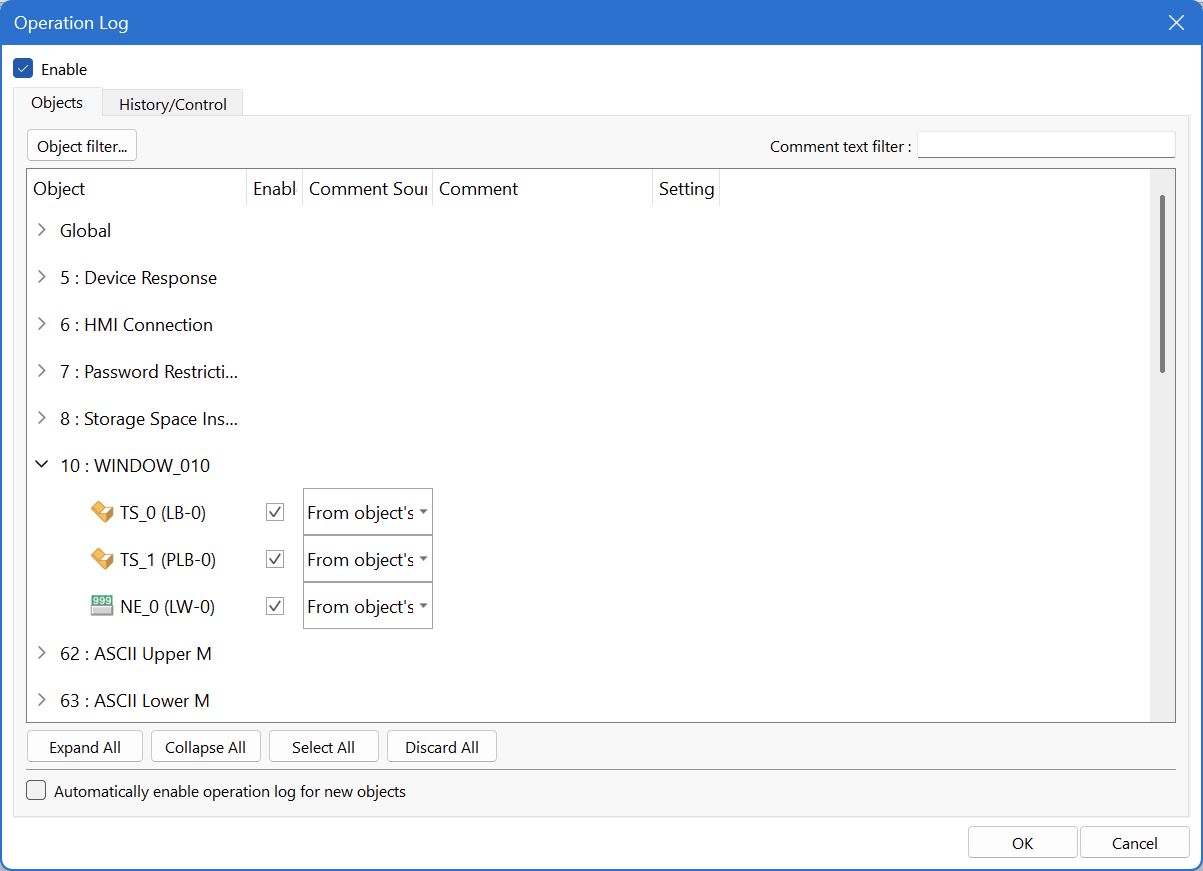

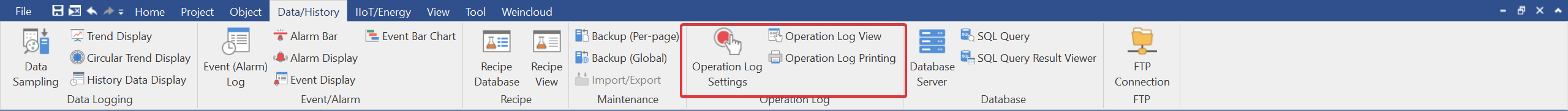

Hi @fpdynso ,
You can use the operation log and place down an operation log view object. You can then see the difference in hostname when you interact with a selected object on the HMI versus in cMT Viewer
