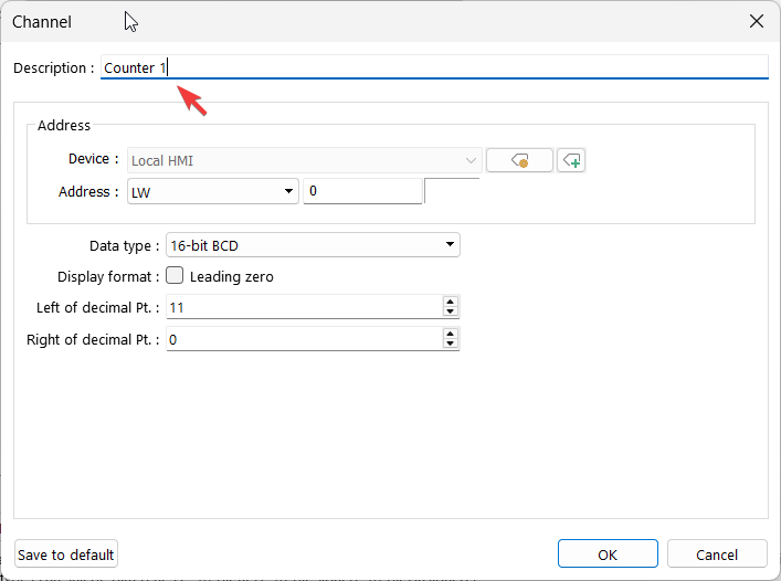

When setting up data sampling object configure a descriptive name for each channel as this will serve as the comment:

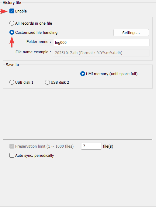

Then, please make sure to enable “History” and “Customized file handling” and select the settings button:

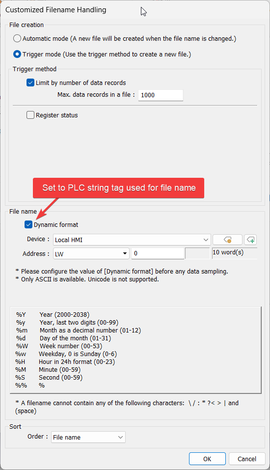

Within the settings menu, enable “Trigger mode” and set the “Dynamic format” address to the PLC string tag used for the file name:

Thanks for the reply. That gets me close; but the file name isn’t working. Even with dynamic format selected the file name is whatever I enter into the “folder name” text box on the sampling setup screen.
I am using a Rockwell PLC and looking at a string tag in the PLC, could that be causing an issue?
@jnorris,

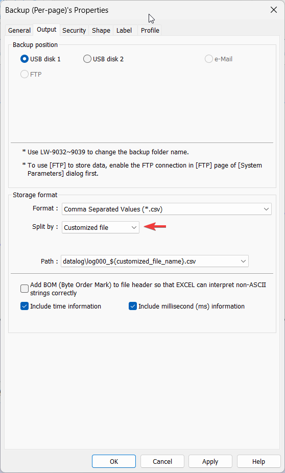

Can you please make sure that the “Split by” option is set to “Customized file” and try this one more time?
Note: An example file path is show within the “Path” drop-down list.
Thank you! That was my problem.

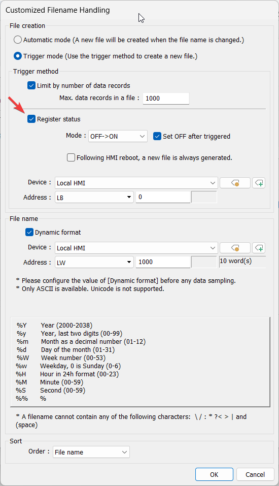

I would recommend adding a “Register status” address as in this example:
Then, when you trigger this bit a new file will generate.

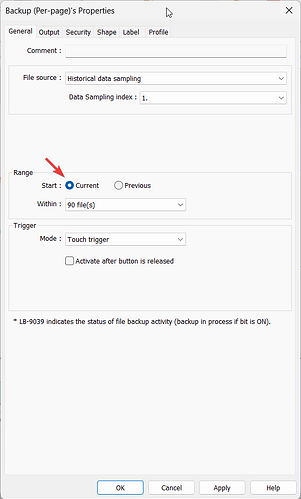

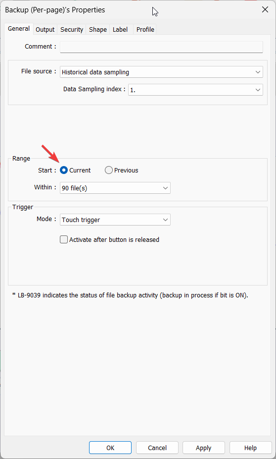

Do you have “Current” selected within your backup object’s settings?
Yes I have “current” selected.
Starting from scratch. if my file name is “ABC” then I can trigger a data log, then trigger a backup, and no CSV file will be on the drive. If I change the file name to “123”, trigger a log, then trigger a backup, then I get a CSV file named “ABC” with the previous log data.
It is like it is functioning as if I selected previous instead of current.
