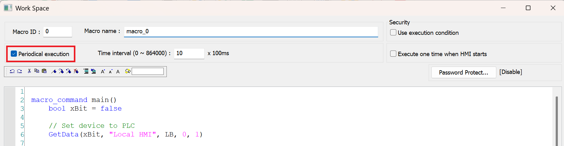

Hi @jperry ,
Here is an example of how you can test this. Please ensure that Periodical execution is checked at the top of the macro to simulate the HMI heartbeat.
	bool xBit = false
	// Set device to PLC
	GetData(xBit, "Local HMI", LB, 0, 1)
	// Toggle the bit value
	if xBit == false then
		xBit = true
	else
		xBit = false
	// Write back to LB-0
	SetData(xBit, "Local HMI", LB, 0, 1)
