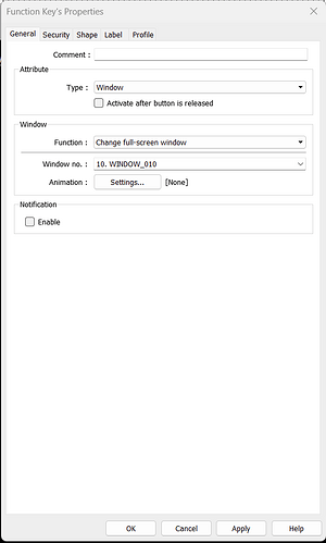

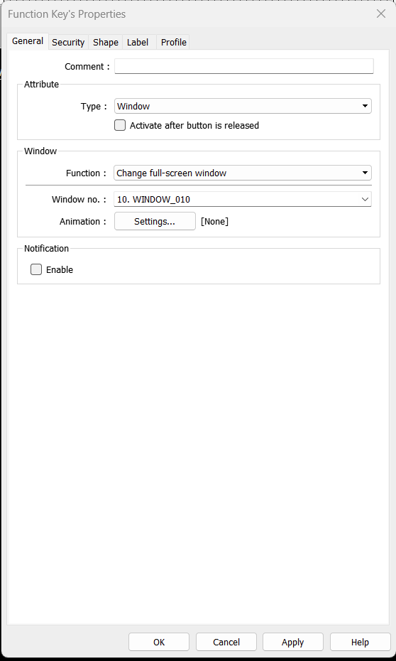

  1. Within your screen saver window, change the function key from" return to previous window" to “change full screen window” then select a specific window to return to.
  2. Use “Change full-screen window” throughout your project on all windows rather then “return to previous window”.

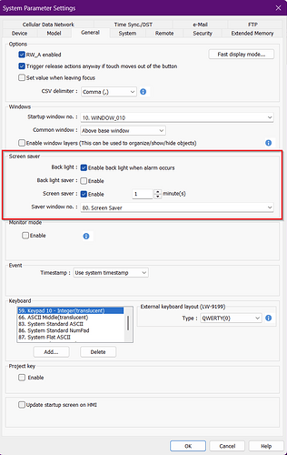

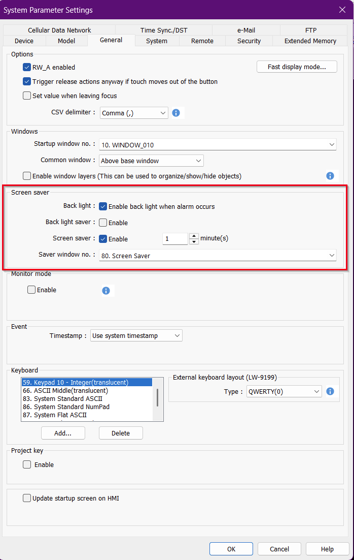

  3. Turn off the screen saver function from within “System Parameters”
