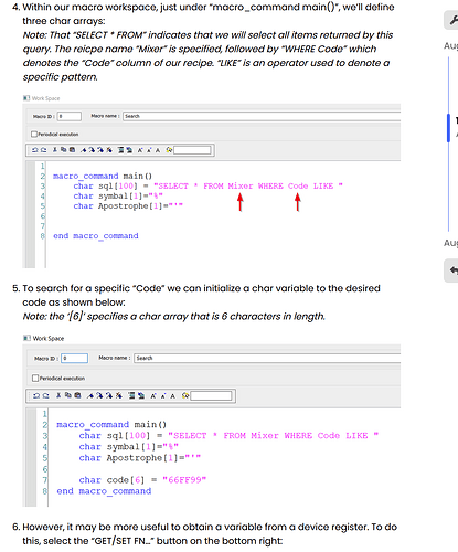

The recipe query function needs the SQL query to be held within the CHAR array. Below is a post that has examples of how to set this up. LINK
Please let us know if you have any additional questions
Im calling the statement from a macro….
Within the advanced section we had set up the recipe query request by placing in array of char. Would this step up work for your project?

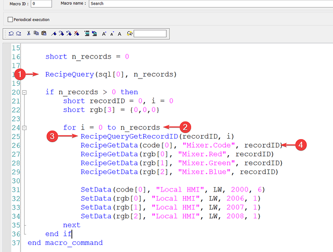

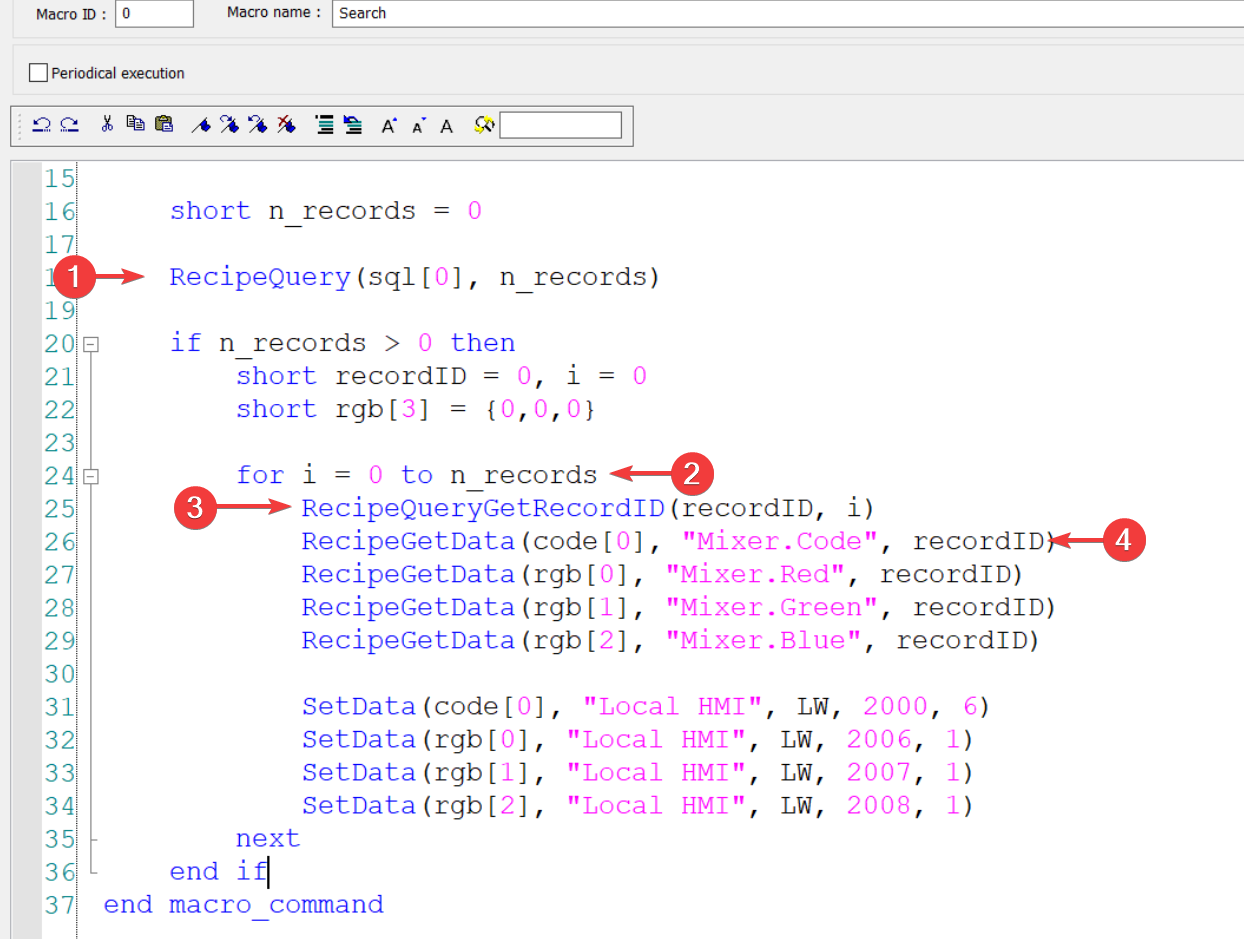

In your macro, you can move the RecipeQuery("SELECT * FROM ...", total_row) call outside of the for loop. RecipeQuery returns the number of records found and stores it in total_row.
Then, use total_row to control the loop count—for example, for i = 0 to total_row - 1—and call RecipeQueryGetRecordID(recordID, i) inside the loop. This retrieves the record ID for the i-th row in the query results and writes that ID into recordID.
Once you have recordID, you can use it with functions like RecipeGetData(..., recordID) and RecipeSetData(..., recordID) to read from or write to that specific recipe record.
Below is a example of the set up. Please let me know if you have any questions. Futhermore, if you want to install breakpoints to further investigate your macro here is a article to help you debug your macro. LINK

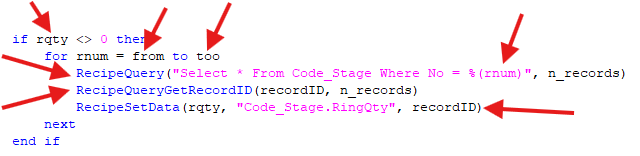

User selected “No” 5 thru 15 within recipe “A”, within that selection they are modifying the “RingQty” field.
Within the range a query is driven from the “No” field.
rqty = RingQty object box (Numeric)
from => Chart “No” starting range
too => Chart “No” ending range
  1. RecipeQuery looks for the row with “No” = rnum
  2. RecipeQueryGetRecordID gets the recordID within the proceeding query
  3. RecipeSetData, updated the “RingQty” field for that row of data within the query, recordID.
Using this code, RecipeQueryGetRecordID will always return “0”, thus when the RecipeSetData runs it’s changing the recordID “0” within the entire recipe. This isn’t what i was assuming this would do, i thought the recordID would be captured from the proceeding RecipeQuery.

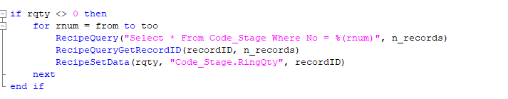

Ended up with this, seems to work. (Let me know if you see a failure point)
Hi @outbound6,
I did not see any issues in your most recent code.
