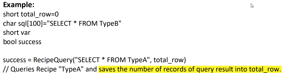

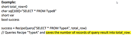

@outbound6,
Within macros, the record “count” is returned when you invoke the RecipeQuery function, there is no need to select the count in your statement.
