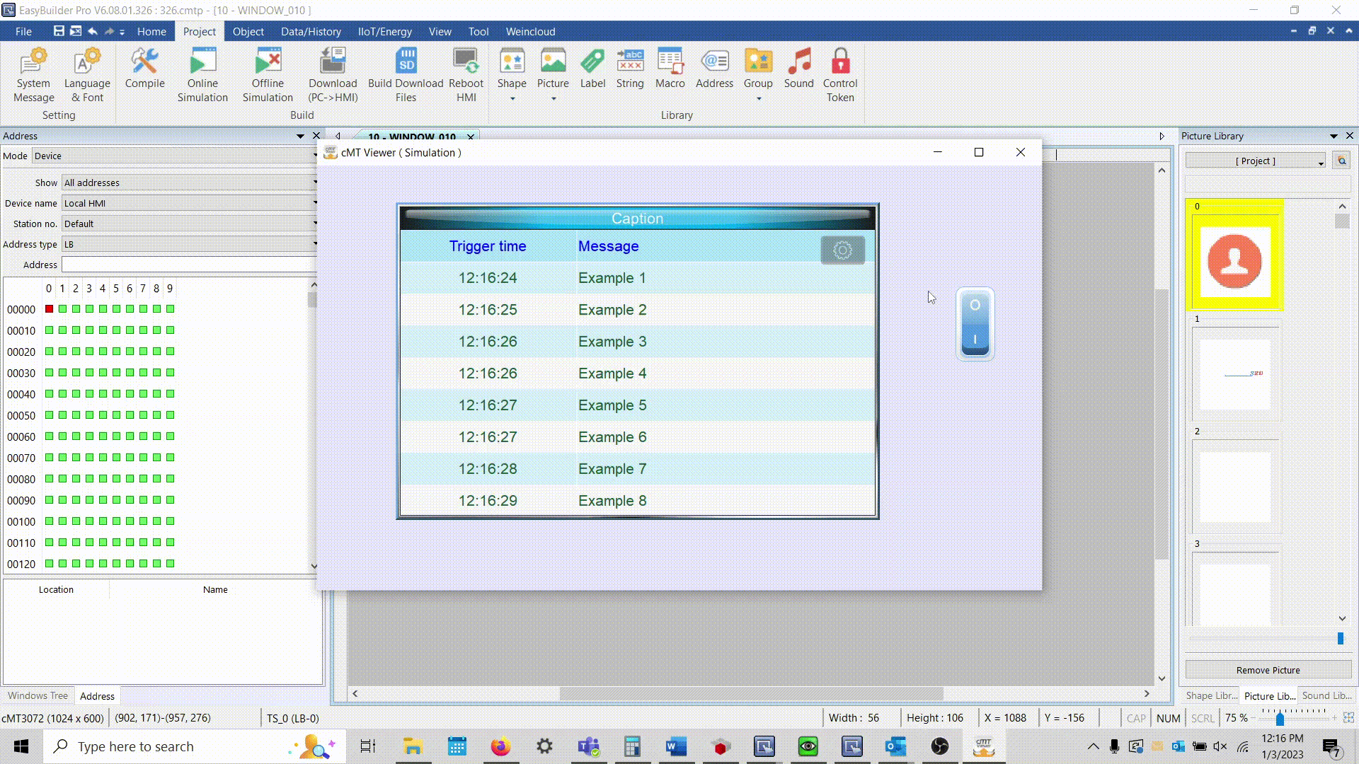

    I cannot seem to scroll down in my Event Display. I am using it for an Alarm History but if there are too many for the screen they are not displayed. I tried using a slider for the Scroll address but it doesn’t work very well.
Hi @dcarie3,
The scroll bar on cMT(X) series HMIs is hidden when not in use. I typically recommend that users click and drag within the object to scroll up or down instead of using the built-in scroll bar:
