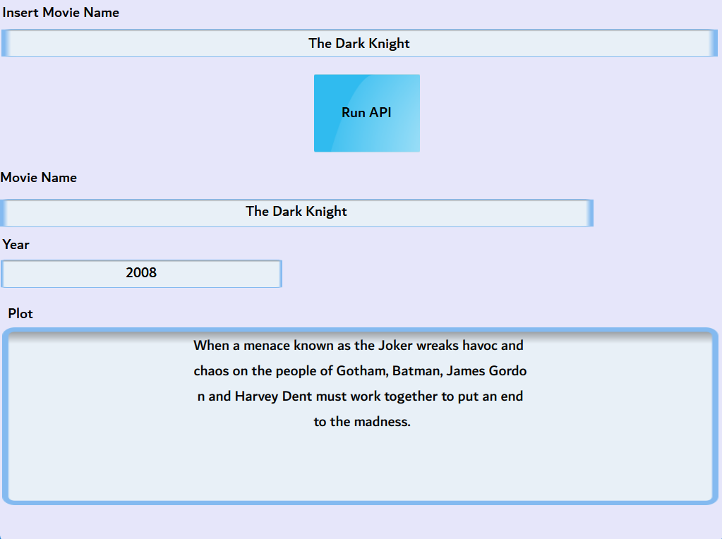

How to use JS objects to call API Requests
Introduction:
This guide explains how to use JavaScript (JS) objects in EasyBuilder Pro to interact with API services and manage data. For this demonstration, we will use the OMDB API, which allows us to retrieve information about a specified movie title.

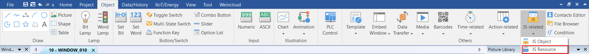

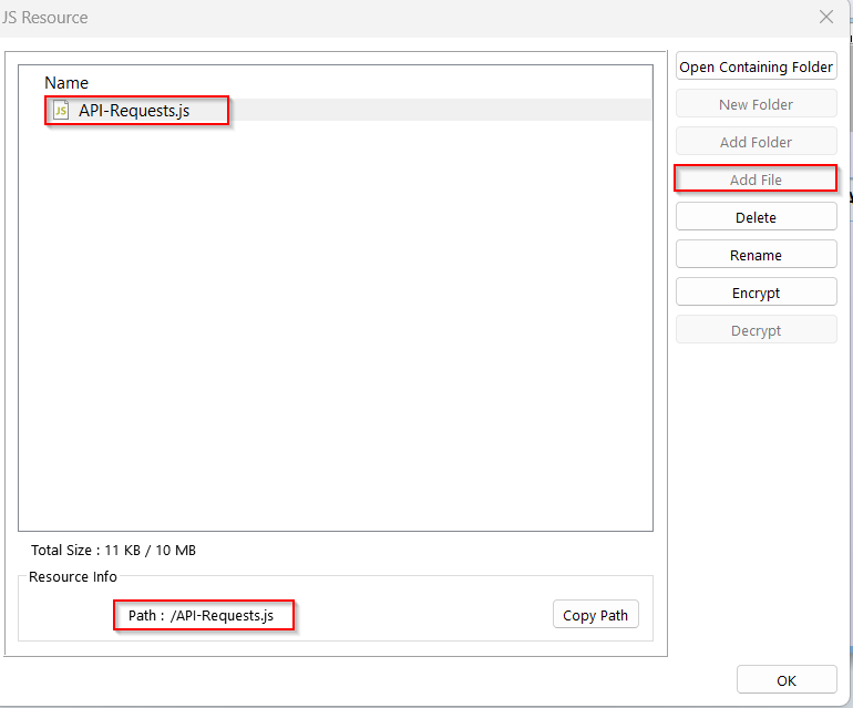

  1. To start the project, you need to add a JavaScript (JS) file to the JS Resource. To access the JS Resource, go to the Object tab, and under the JS-Related section, select JS Resource.
  2. In the JS Resource, click on Add File and upload the provided JS file below. This file contains functionality for performing API requests such as POST, GET, and DELETE. Additionally, copy the Resource Info, as it will be needed later to specify the file path in our JavaScript script.

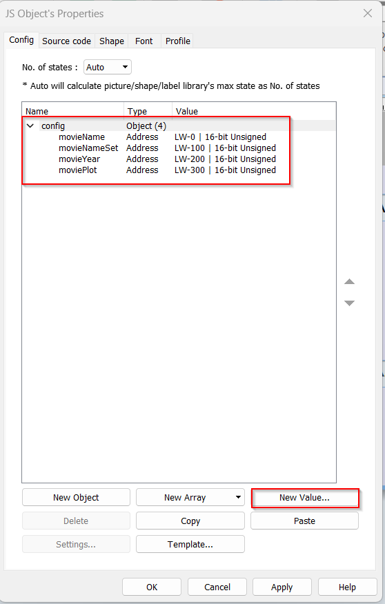

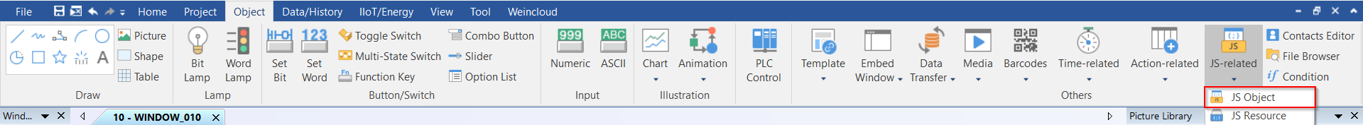

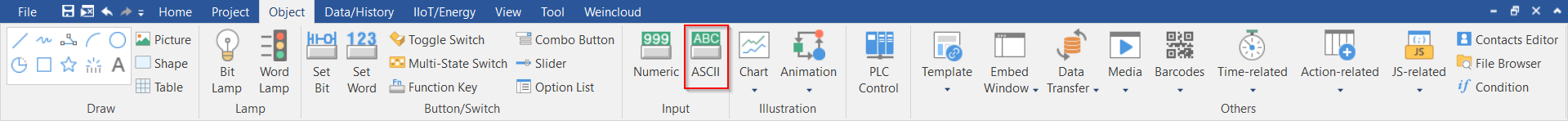

  1. Next, navigate back to the JS-related attribute, and select JS Object.

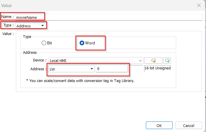

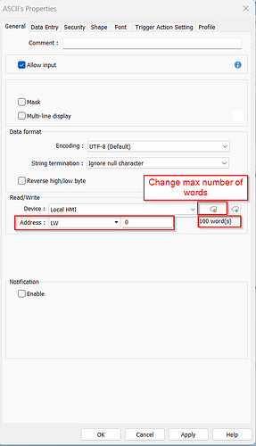

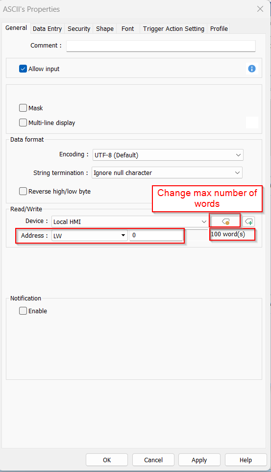

  2. Within the config tab we will set up our ASCII objects that we will create later on. Select the New Value button to create each object.
  3. When creating each New Value I enter in a Name, the Type will be a Address, Value Type will be set to Word as the demo will be dealing with string, and address will be set to open address.
    Same steps was repeated for all other variables shown above at open memory address.

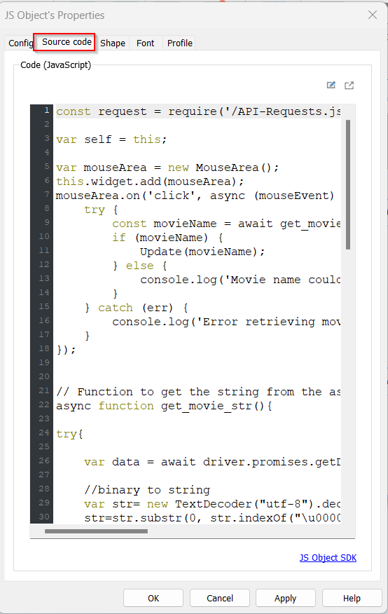

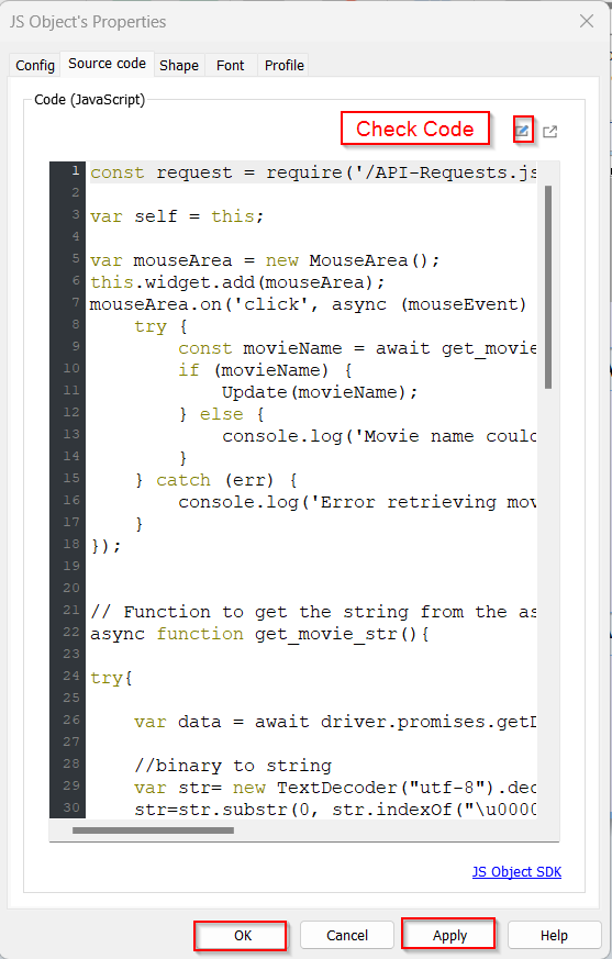

  4. Next, navigate to the Source Code tab to begin implementing your code
  5. First we will start by adding the resource file we adding in earlier and set up a self variable to preserve our memory when changes occur.
const request = require('/API-Requests.js');
var self = this;

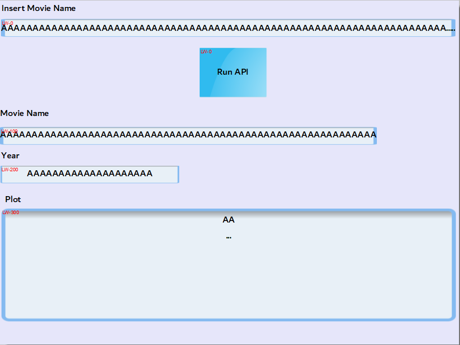

  1. The location of the ASCII object, accessed using the self keyword and the corresponding property within the config object (e.g., self.config.movieNameSet).
  2. The maximum number of characters allowed for the ASCII object (set to 30 for this demo).
  3. The variable containing the data to be displayed in the ASCII object.
    This function ensures that the extracted data is properly formatted and displayed in the corresponding ASCII objects.

  1. Lastly, we will set up the MouseArea functionality in the JavaScript script. This enables the script to execute specific functions when the object is clicked. To create a MouseArea, start by defining a variable with the new MouseArea() function. Then, add this widget to the project using the this keyword.
    Next, an event handler function will be defined to process the sequence of events triggered when the JavaScript object is clicked. The mouseArea.on() method will be used for this purpose. The first parameter of mouseArea.on() is 'click', indicating that the event sequence should only execute when the object is clicked. The event handler function will be declared as async to ensure the completion of promises, such as API calls, before proceeding.
    A try-catch block will be implemented to handle any errors that may occur during execution. Inside the try block, the get_movie_str function will be called to retrieve the movie name provided by the user. If a movie name is entered in the ASCII object, the Update function will be executed with the movie name as its parameter to update the other ASCII objects. If no movie name is provided, an error message will be displayed.

  1. After implementing the code, select the Check Code button on the top right of the page. Then you can apply the code to the JS object using the Apply button on the bottom right, and place JS object using the OK button
  2. Next we will set up the four ASCII objects that were used within the JS object. Within the Object tab select the ASCII object.
  3. Within the General tab, ensure the Address matches up the configuration of the JS object and the memory address does not overlap with another memory address. Furthermore, manipulation of the max number of words per ASCII object using the yellow tag button.
  4. Place all of the critical ASCII object within your project with appropriate labels.
    If large amount of text like the PLOT attribute use multi-line display found in within the General tab

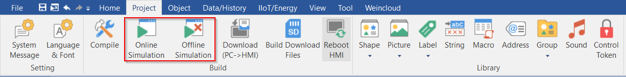

  5. To run a simulation navigate to the Project tab and select Offline Simulation or Online Simulatiuon.
    DEMO Simulation
Full Code
var self = this;
var mouseArea = new MouseArea();
this.widget.add(mouseArea);
mouseArea.on('click', async (mouseEvent) => {
    try {
        const movieName = await get_movie_str(); // Await the result of get_movie_str
        if (movieName) {
            Update(movieName);
        } else {
            console.log('Movie name could not be retrieved.');
    } catch (err) {
        console.log('Error retrieving movie name:', err.message);
// Function to get the string from the ascii object
async function get_movie_str(){
try{
    var data = await driver.promises.getData(self.config.movieName, 100); // Get the data from the ASCII object
    //binary to string
    var str= new TextDecoder("utf-8").decode(data.buffer);
    str=str.substr(0, str.indexOf("\u0000"))
    return str;
} catch (err) {
    console.log('Error:', err.message);
// Function to run the API call with the movie name passed in
async function Update(movieName) {
    try {
        // Call to API to get the data
        request.get({
            url: 'https://www.omdbapi.com/', // API url base
            // Following API feilds
            data: {
                t: movieName,
                apikey: 'dba4d21d'
        }, updateFeilds); // Callback function to update the feilds
    } catch (err) {
function updateFeilds(error, response, body) {
    try {
        const payload = JSON.parse(body); //Prase the whole return of the API call
        // Get the needed attribute feilds
        var movieName = payload.Title;
        var movieYear = payload.Year;
        var moviePlot = payload.Plot;
        // Help the movie plot fit into box by putting in a new line every 50 characters
        moviePlot = moviePlot.replace(/(.{50})/g, "$1\n");
        // Set the data using driver methods
        // Puts the data within the ASCII objects
        driver.setStringData(self.config.movieNameSet, 30, movieName);
        driver.setStringData(self.config.movieYear, 10, movieYear);
        driver.setStringData(self.config.moviePlot, 160, moviePlot);
    } catch (parseError) {
        // Error catcher
        console.log('Error parsing API response:', parseError.message);
