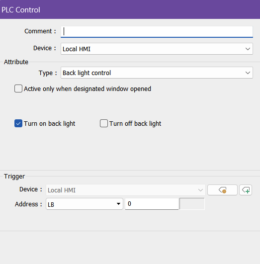

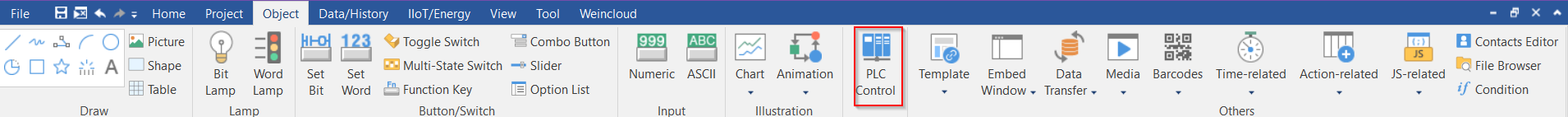

Thank you for contributing to our forum. To turn the screen on externally, you can set a bit remotely. Within the object tab, you can create a PLC Object. By selecting the type as Backlight Control, you can trigger the backlight to turn on. In the example I have set up the trigger as the LB-0 bit, but feel free to modify this as needed for your project.

PLC Control Location
PLC Control Setup
