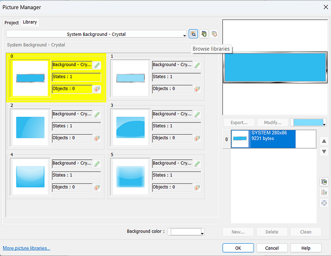

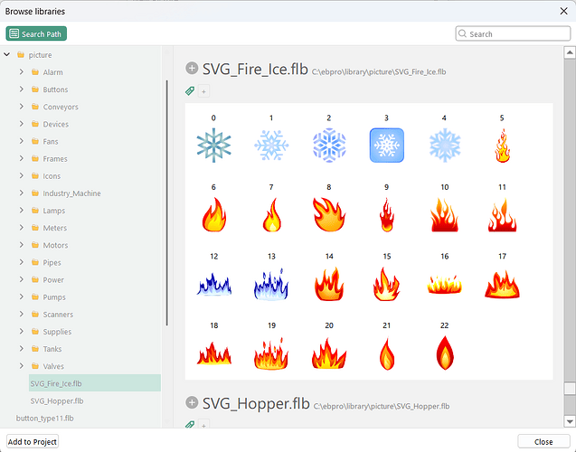

Great question! To install picture libraries from our website simply unzip the file into the “picture” folder located within the “EBPro” folder on your computer. The file path should be something like this C:\EBpro\library\picture .

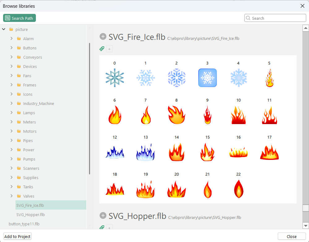

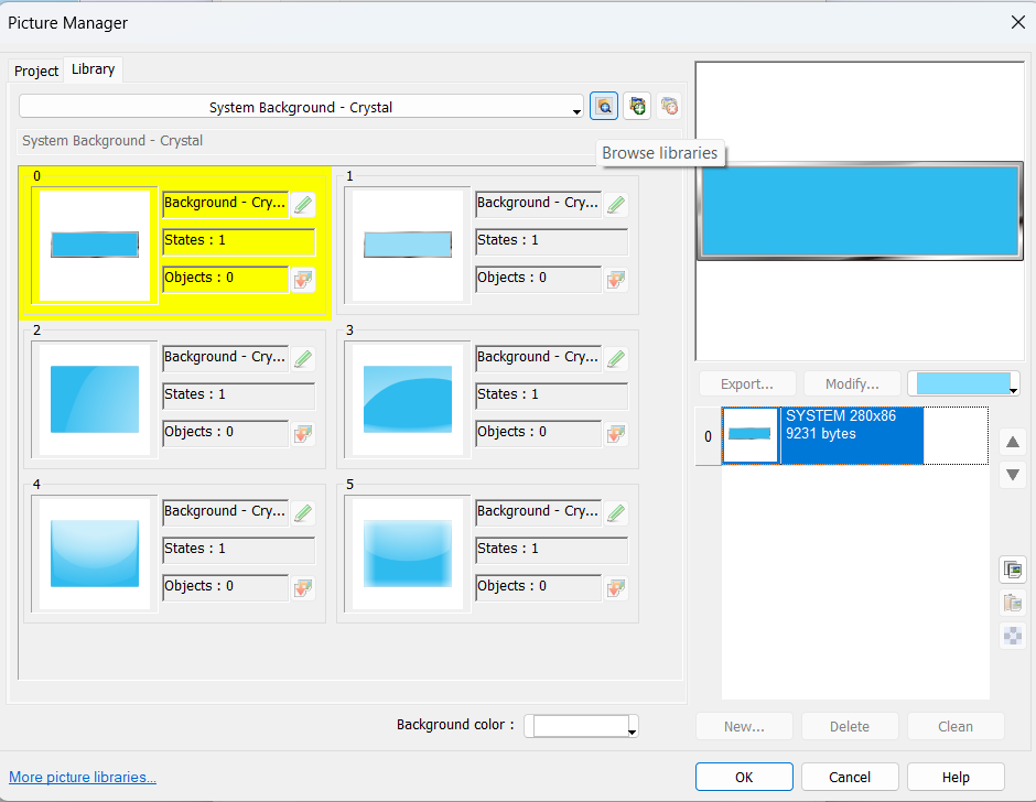

Once the files are in there go ahead and open up EBPro or restart the application if its already open. Navigate to the Picture Manager and “browse libraries”, there you should find your new picture libraries that you have just uploaded.
