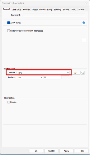

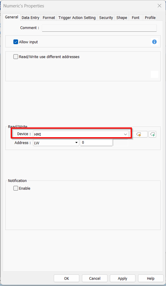

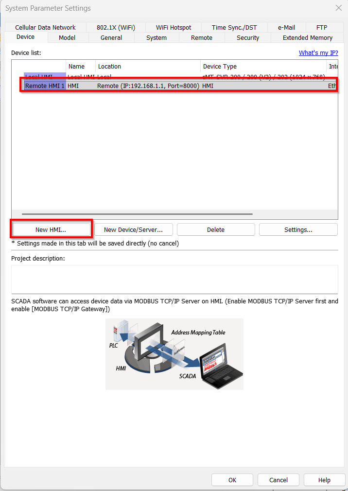

To set up Ethernet pass-through from the SVRX to the cMT, you will need to add a New HMI device within both projects. This newly created device will share the same IP address (for example, 192.168.1.1) to allow the two HMIs to communicate.
You can then assign the device memory addresses of each object you want to share between the two HMIs to this new device.
Once configured, both HMIs will be connected through the shared memory addresses.

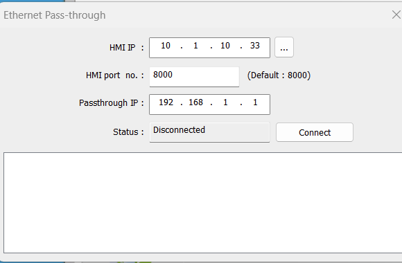

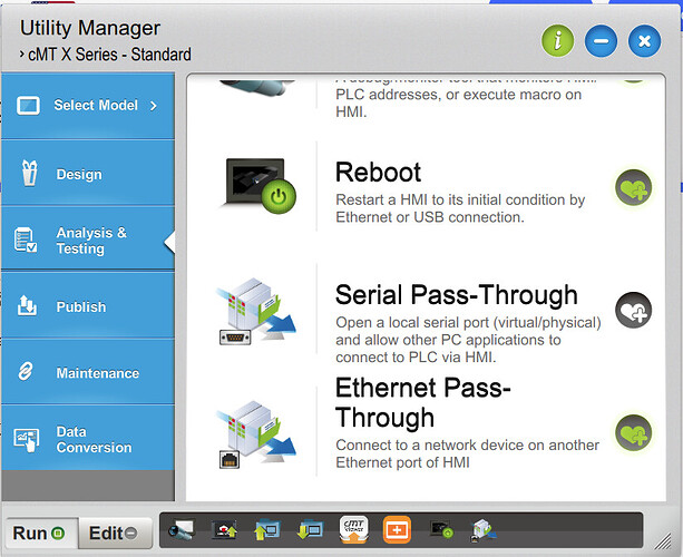

Lastly, in Utility Manager, enable Ethernet Pass-Through. The HMI IP should be the SVRX’s Wi-Fi IP address, and the Pass-Through IP should be the IP address of the newly created HMI device.
