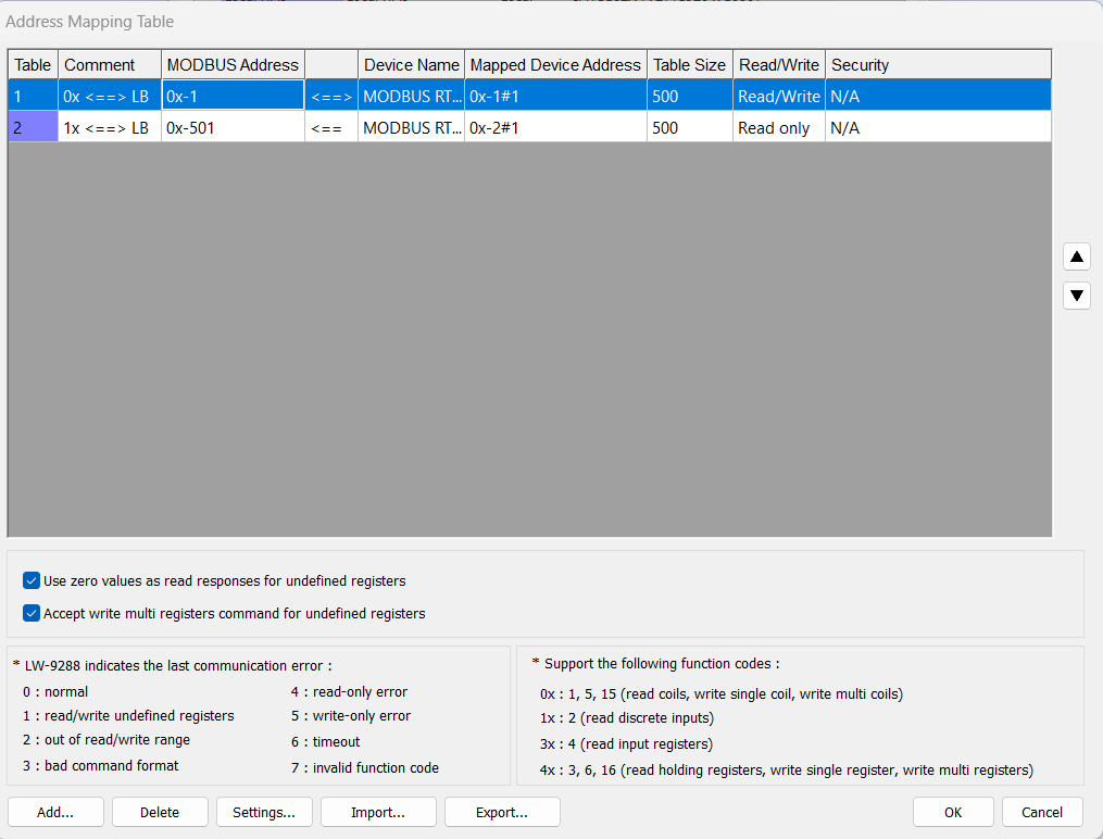

Yes, this should be possible. You can have a single Modbus RTU master communicate with multiple stations and map the data using the Address Mapping Table. For each mapped address, you will need to specify both the station number and the device address. The syntax would be 0x 2#1, where “2” represents station 2 and “1” represents the 0x address offset of 1.
