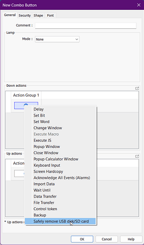

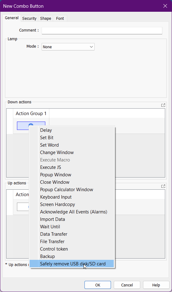

Before removing the SD card / USB disk, or disconnecting from the database server, please synchronize the event log data using the control address.
Furthermore, I suggest setting up a combo button with the Safely remove USB disk/SD card action.
Please let me know if you have any other questions.

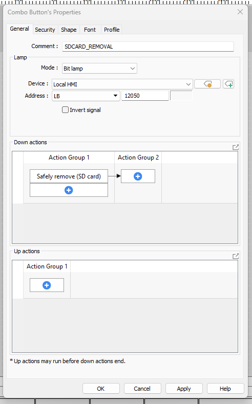

Got that in their….
When i hit this button the Bit Lamp doesn’t indicate that the state has changed. I remove the SD Card and it’s locked.

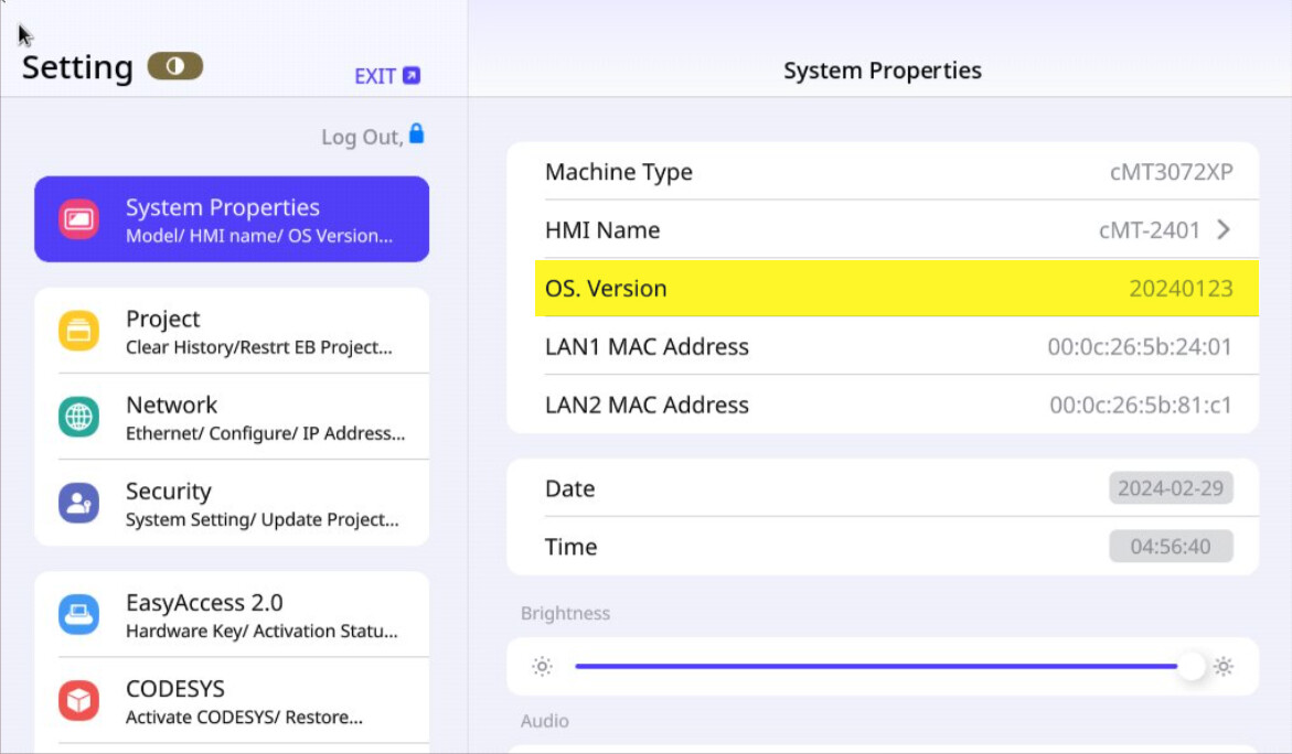

Is your SD card formatted to FAT32 and what OS version are you running are you running on your HMI?
@outbound6,
The OS version is shown within the HMI’s system menu:
It is
not the same as the EB pro version.
