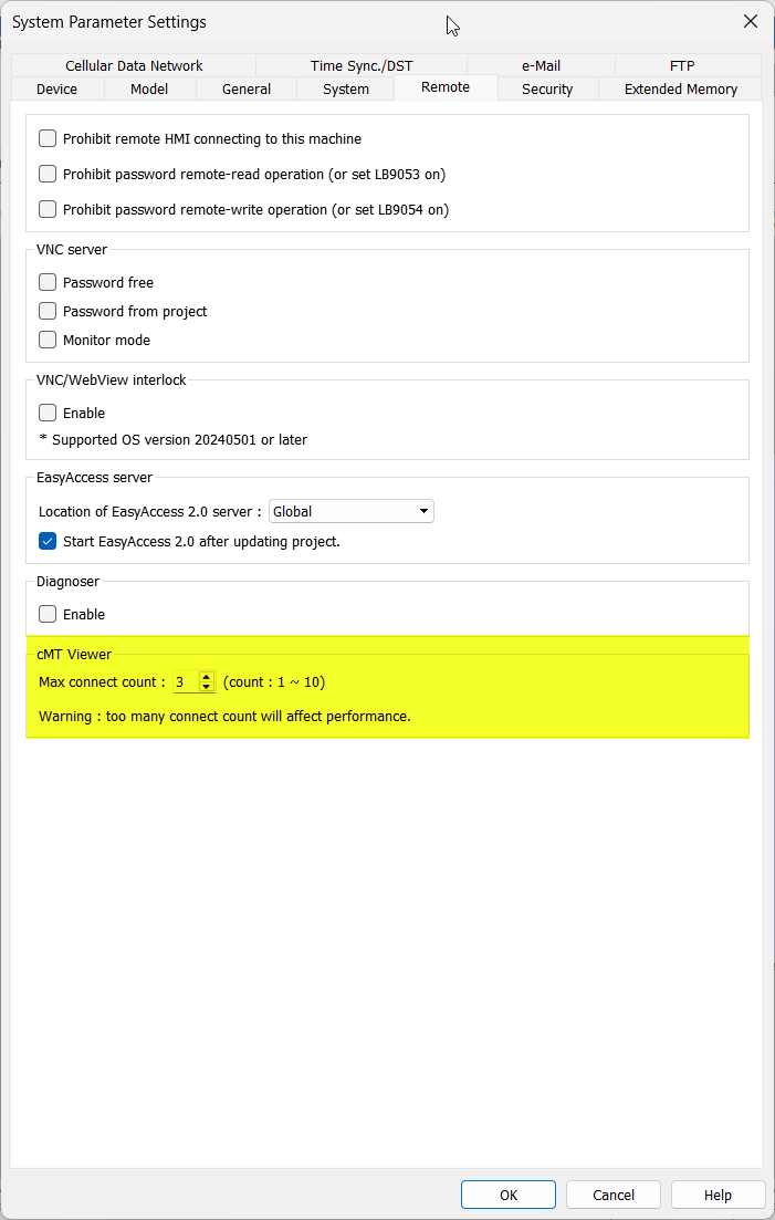

Each HMI can support 3 clients connections, but if configured it can support up to 10. This can be done with System Parameters > Remote Tab > CMT Viewer section.
Please note that this is only for local connections.
