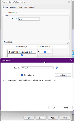

It is not possible to create a PDF within EasyBuilder Pro. We recommend using a Screen Hardcopy through a function key or combo button. This will generate a JPG image of the screen and place it within USB1 or USB2.

Combo Button set up with screen hardcopy
