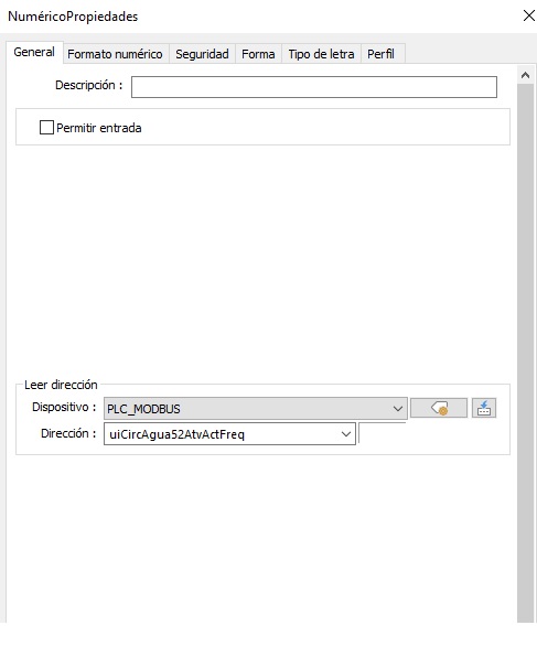

    When importing Tag list with address changed. The fields in the screen where the Tags is used keeps the address instead of keeping the tag. I exported the Tag list then changed the address (keep the same Tag names) and the imported it again and the fields (numeric field, toggle button etc.) stayed with the address instead of keeping the Tag name. Is there any setting to change this behavior?
Hi @diegomb20,
Can you please post some screenshots of the before and after configuration so that we can see what you mean?
Hi Brendon,

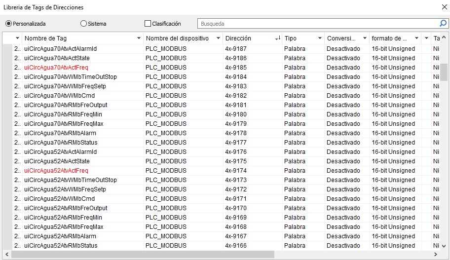

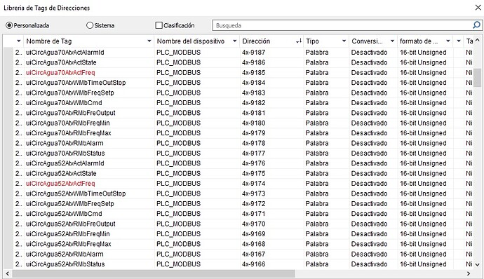

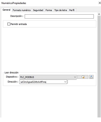

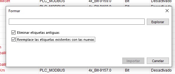

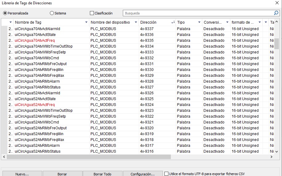

The pictures attached show the addresses before and after the tag import. The Tags name were the same before and after the import, only the modbus address was changed. The numeric object pointed to uiCircAgua52AtvActFreq (modbus addres 4x-9174) and after the import the same numeric object pointed to other Tag name with the same address. The import settings was done with both option checked (delete old tags and replace existing tags with new ones)
Hi @diegomb20,

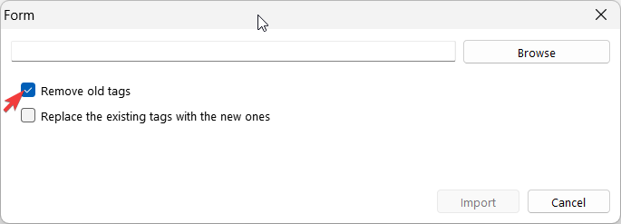

Thank you for clarifying, in this case please only select “Remove old tags” during import:
