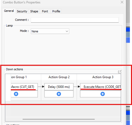

For troubleshooting purposes can you please add or change the following and let us know the result:
  • Add a Recipe View object for Code_SQL
  • Add ASCII object addressed to EM1-0 memory
  • Add ASCII object addressed to the Code_SQL.CodeTop recipe
  • Change the 10ms delay to 1000
  • Change the 50ms delay to 1000
When finished please run the macro and let us know if the CodeTop data transfers from EM1-0 to Code_SQL.CodeTop. And, please confirm if the data in Code_SQL.CodeTop is then added to the recipe database.
