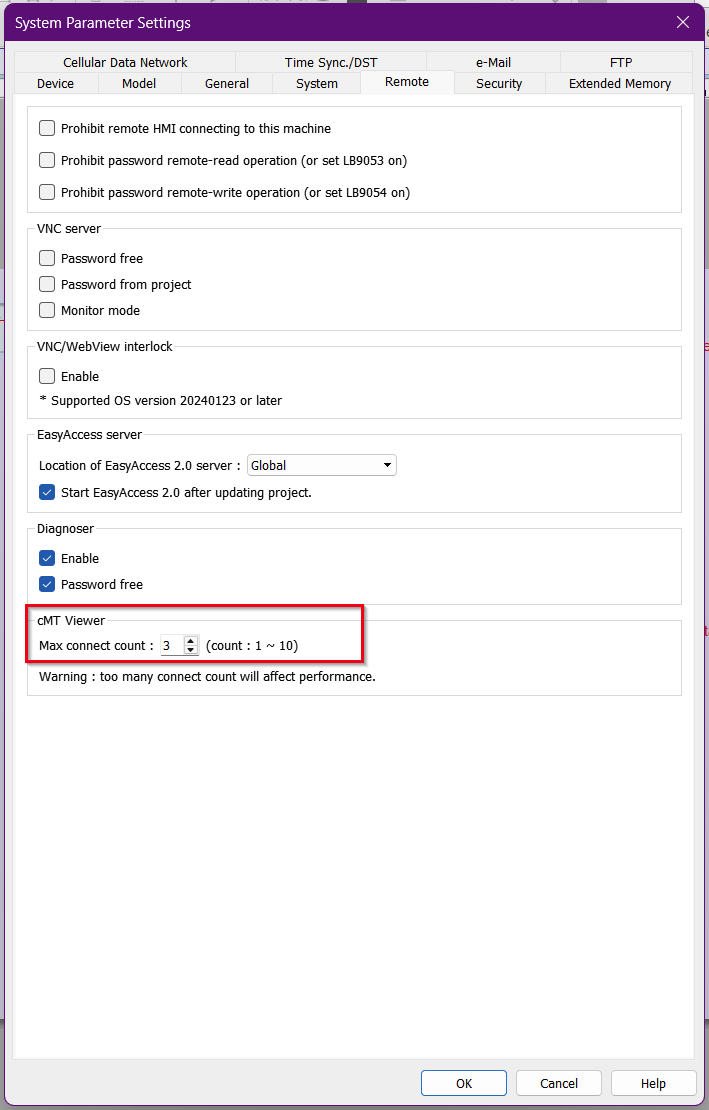

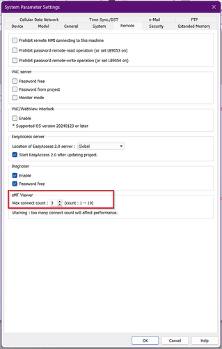

Hi @eddy_neves ,
Yes, cMT Viewer is not solely a view client, as it can execute certain actions such as specific programs or requests on the PC rather than directly on the HMI. From a security perspective, cMT Viewer should therefore be protected according to the project’s requirements, as you mentioned.
Additionally, access can be further controlled by limiting the number of concurrent cMT Viewer connections through the system parameters.
