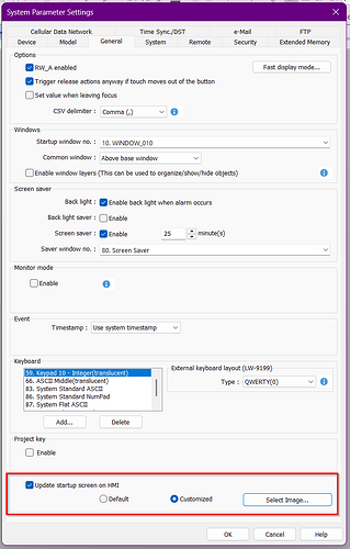

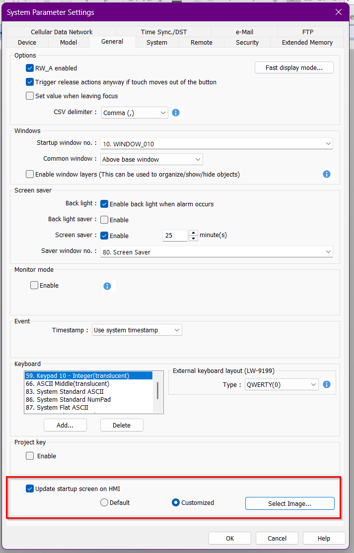

How do I add a 5 second splash page at HMI powerup with a 5 second or so delay before proceeding to the Main Page?
Hi @Cleandrew ,
For a quick image to display before navigating to the main page, you can enable “Update startup screen on HMI” under the General tab in System Parameter Settings, then select the image you want to show at startup.
Please note that the image must be in .bmp format.
Please let me know if this works as a solution for your project.
Thank you so much for the rapid response. It worked perfectly. ![]()
