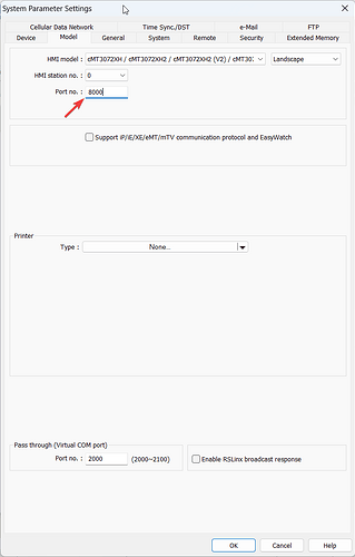

Hi @thelsn,
Thank you for contributing to our forum! This was a great write-up, also please note that the port number is configurable within the model tab of the system parameters:
Oops, didn’t realize you could just change the port
Thanks for pointing that out, you learn something new every day.
